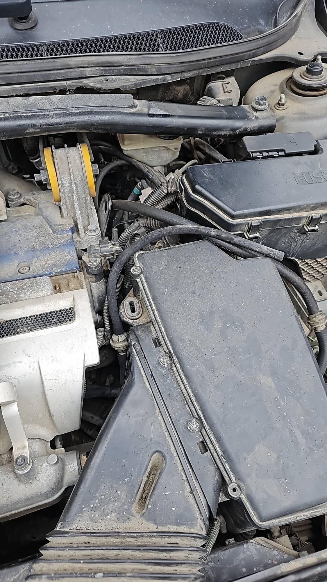

Hi, can someone help to locate where does this vacuum hose connect to in 04 v70R

That’s the back end of the purge valve system so it probably goes way down into the snorkel near the turbo. It’s a tough spot to access , you might need to move stuff to get that back on
