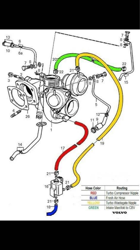

Noticed today my turbo inlet to TCV vacuum line was torn (red see pic attached) so I replaced it and double checked all the vacuum lines were in the correct place.

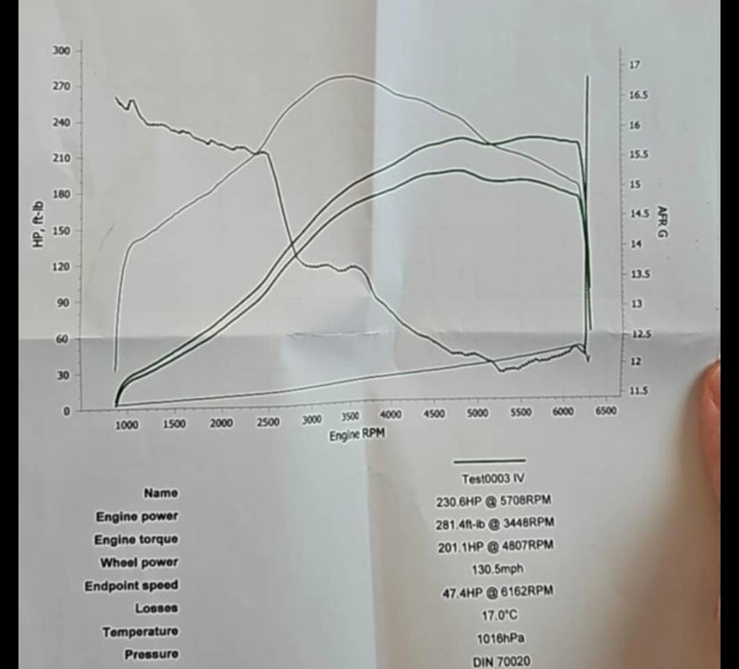

Before replacing it I was consistently getting 10 psi but now I'm getting about 6-7psi max.

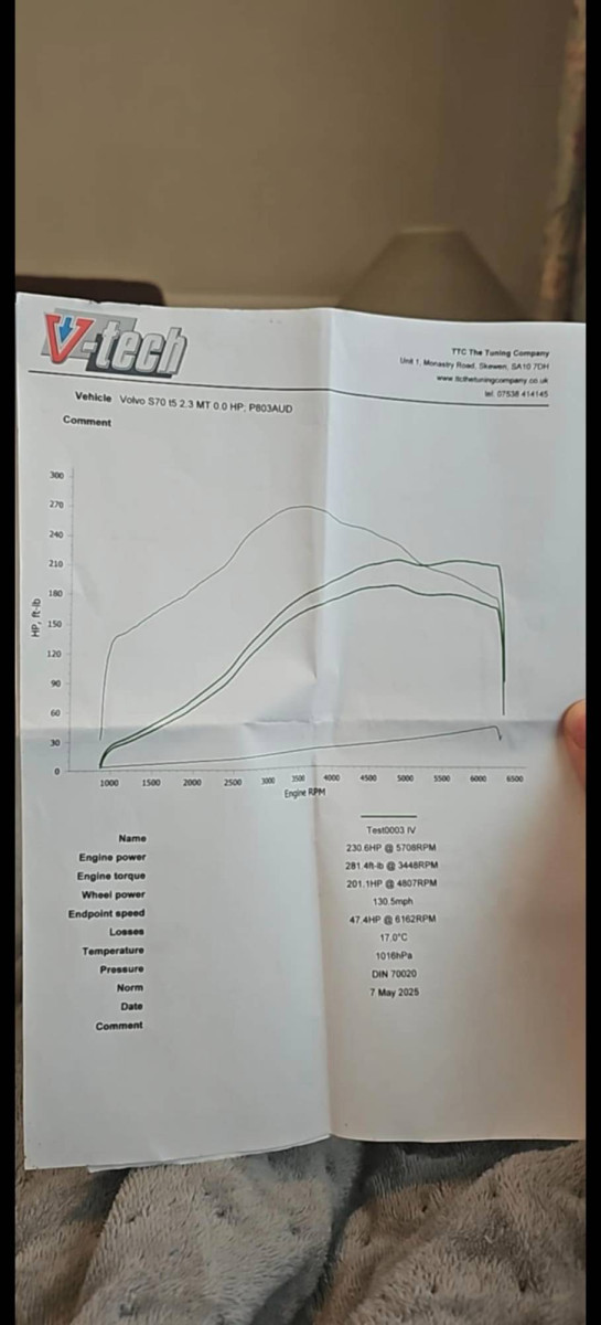

My question is: how much should a stock T5 be making? If my new figures are not consistent, what could be wrong to explain this loss in power? I've attached an image of my dyno result if that's any help (the vacuum line would have still been torn at this point).

11-12psi is normal. Your problem is almost certainly a vacuum line or cracked vac elbow.

The stock TCV is only good to around 12 psi. It starts to get flaky at 14 psi.
What pipe did you use? If it is on a vacuum side then it may be collapsing under boost.

Thanks guys, was always under the impression that 10psi is what the car should be making stock. I've been using the same silicone hosing for all of my vacuum lines (https://amzn.eu/d/dyNrdBF)

I'm getting P0136 & P0141 as I only have the front sensor, no rear. I get about 320 miles in a full tank 80% Urban 20% Motorway. Have been monitoring boost pressure with TCV red disconnecting and it will get close to 12psi in 2nd gear and 15psi in third. With all the lines attached to the TCV it seems to vary a lot, sometimes 5 psi, sometimes 8 etc.
I could purchase another TCV to rule it out as being the problem, I had a quick check of all the vacuum lines and the yellow-ish one that runs from the FPR regulator is quite perished / rotten so I'm going to replace that tomorrow morning.

That's 20mpg, which is completely normal for a P80 HPT. Good even, with that split city/highway.
Disregard boost in 1st gear. 12-15psi is very healthy.
