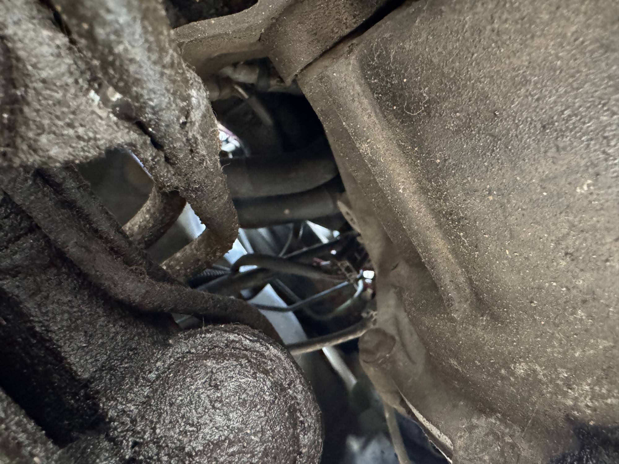

Our car was towed last week; upon picking it up at the tow yard in Denver, it would only move 20 feet before the engine stalled.
I ordered a new MAF from Penguin Parts and installed it, but the same issue with stalling persisted. Two possible issues from
\reading forum posts. Always use a Bosch MAF. There is probably an issue with a vacuum leak, because a hose is missing from
the pipe downstream from the MAF, as shown it a picture. The underside picture of the engine doesn't show any obvious destinations for where to attach the missing hose. If someone has a suggestion, I'm open to it. Just in case the open port is a problem I can try buying a cover for it.

Look under hood on the right side for a sticker with the vacuum hose routing. They vary between models amd engines in a given year, so you need your diagram. That might be the fuel pressure regulator vacuum supply, needed

Yes it goes to the fuel pressure regulator but check your sticker to be sure.
See bullet point #3 in this post: viewtopic.php?t=63615

Here is my 1998 turbo sticker.

What happens if you unplug the MAF entirely? Should still start but run really rough.

@rocky_mtn_man this might match your XC70 https://www.matthewsvolvosite.com/vacuum-lines/
