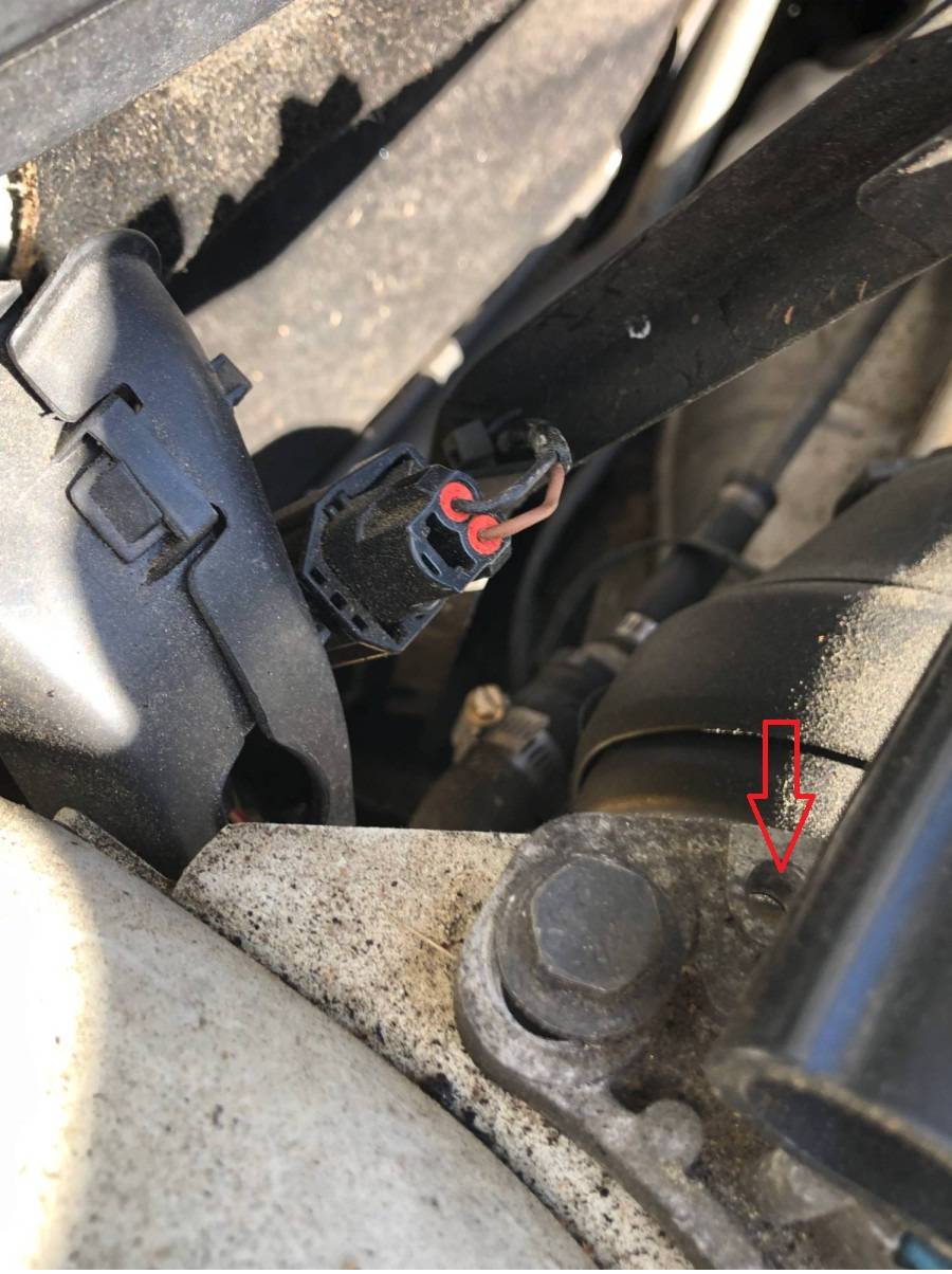

What is this wire and how to attached cover to engine bay? Just hanging around.
2007 S60 2.5T What Is This Cover & How To Attach?

ABS sensor that goes to the front wheel. Couldn’t tell you how to attach…if someone knows I have same XC90 one that needs to attach.

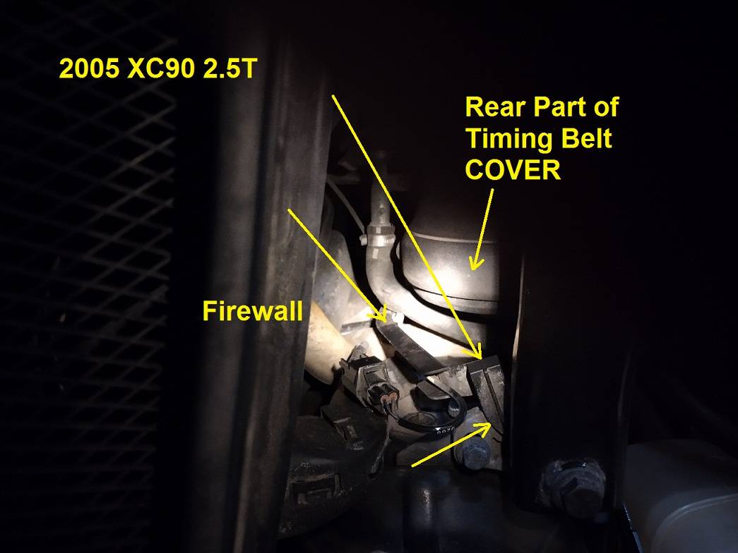

Photo from my 2005 XC90 2.5T showing where it clips to.
HTH.
This plastic thingy is usually knocked out of place when ppl do the timing belt job.
And when the TB job is done, ppl forget to clip it back into place.
HTH.
