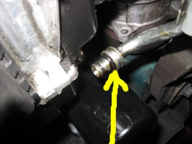

I bought an o-ring kit from Harbor Freight for about $7. I put an o-ring where the yellow arrow is and got mine to stop. Only cost pennies to fix. This is what I bought. 397pc metric o-ring assortment, item 91512
