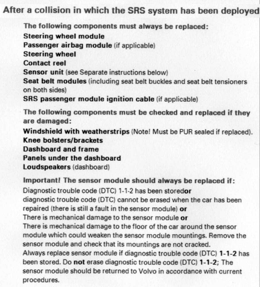

Hopefully you will get it going again without too much trouble.
This is an extract from VADIS on the subject of the SRS deployment:
Bill.
Bill.
