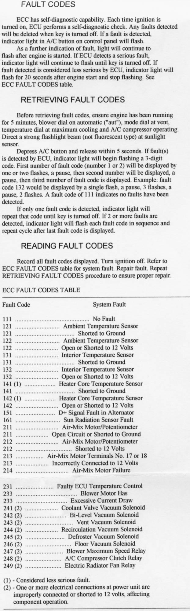

When I started my volvo today, the light around the A/C Off button started to blink. I dont have the manual, and couldnt find the answer on the web. Is it some sort of electrical problem?

This is an indication that there is a fault with the Electronic Climate Control.
You can read fault codes from the ECC:
If you need more help just ask.

That was an easy fix and, hopefully, permanent.
If not, you now know how to diagnose the system.

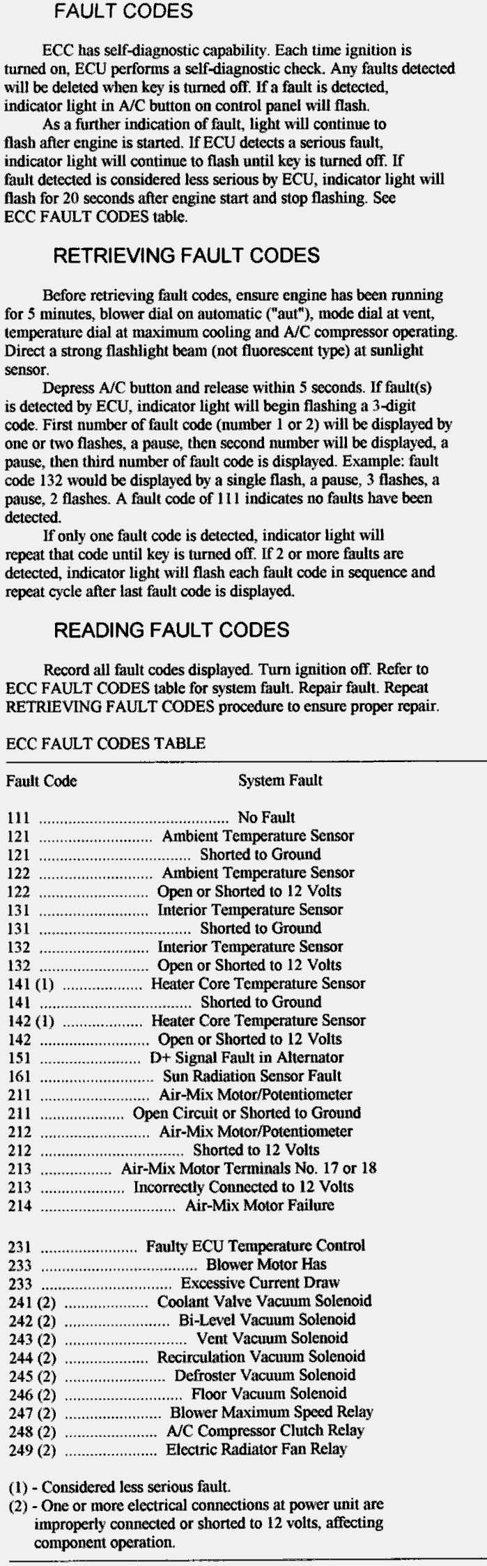

If you're going to print the fault codes attached to this thread, use this attachment.
