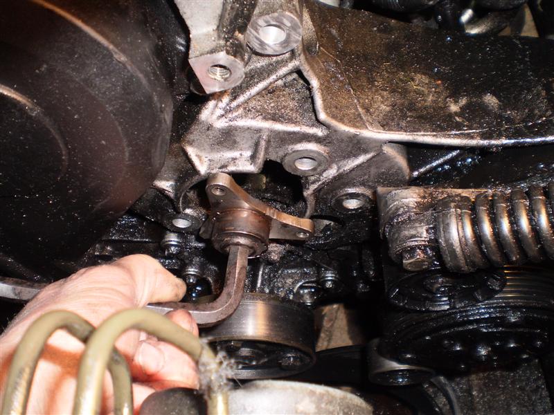

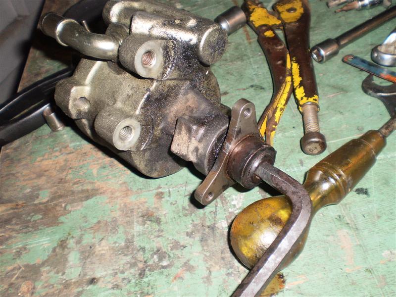

p.s. Sounds brutal I know , but I had to cut the pump shaft in order to remove the pump from the casting. My attached photos show the 3 pronged pulley mounting on the pump and the other in relation to the aperture - i.e. wont go through especially if still attached to the pump. You will see that there is a hexagon type of bolt or nut - but I simply cannot turn it .
- support poulie trop large pour trou.JPG (101.41 KiB) Viewed 1910 times
- pompe avec support poulie en place.JPG (98.54 KiB) Viewed 1910 times

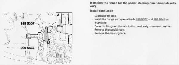

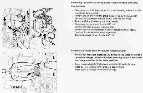

Pictures with French sub-titles! We don't see many of those.
Volvo techs, what do they know? You remove the pulley support using a 3 leg puller.
This is the VADIS instruction: If you need any more please post.
Bill.
My apologies as I misread this bit thinking it was a support for the pump.3 branch support for the drive belt pulley that is on the pump drive shaft
Bill.

Bill
Thank you very much for the graphic assistance - that couldn't have been more helpful !
Of course the one thing I didn't do was take the 'A' dimension before I cut the shaft !!! Oh well will have to do my best when refitting though I do understand the implications ref. belt pulley alignment.
On that subject Bill, do I assume that refitting the flange, (once the pump is reinstalled to its alu mounting excluding flange), is achieved by pressing it on using a bolt screwed into the pump shaft internal thread, together with a nut plus spacers which when tightening the nut should push the flange onto the shaft. Perhaps heating the flange up in the oven may help. Hopefully the shaft will not turn as I tighten the nut !
Would there be a 'Vadis' description of the job by the way ?
Sorry to ask more questions but I don't want to make any more mistakes like the A dimension.

As with many jobs Volvo have special tools but I think an improviser can get around these.
The other part mentioned, 999 5307, is a large spacer/washer.
Hope this helps.
Bill.
Hope this helps.
Bill.

Bill
Once again great info !!
Just a bit of clarification please as to the correct use of the tool, or an improvised version.
Would I be right in thinking that having bolted the tool into the pump shaft internal thread (together with flange and washer), that you turn the nut as if unscrewing it, exerting a pulling force on the shaft, therefore pressing the flange on to it. Or am I misunderstanding the principle, that somehow turning the bolt head achieves the same thing ?
Hopefully this should be my last question on the subject !!

The special tool is obviously threaded with two different size threads.
The way I understand it is that the smaller threaded end is screwed into the shaft and the larger nut is tightened to push the pulley onto the shaft. The large washer/spacer simply spreads out the force exerted by the large nut. To stop the whole thing turning as you turn the large nut you will put a spanner on the bolt head.
Looking at the picture of the tool I think you should be able to achieve the same result by using an ordinary bolt which would screw into the shaft with a nut further up the bolt to exert the pressure. To spread the force more evenly I would use four or five washers between the nut and the pulley starting with a smaller one at the nut and working up in size to that against the pulley.
Bill.
Bill.

Bill
I got my local agricultural engineer to pull off the pulley support from my replacement pump, using a 3 legged puller; though he did have to angle grind a bit off the feet to make it fit and heat the support up as well.
Being loathe over the years to throw anything away I luckily found an old series Land Rover diesel engine manifold stud with the right thread to make my press tool .The pump shaft, which of course is not metric , needed a 3/8'' bolt and voilà I found one ! I don't reckon I would have located such a thing here in metric land.
