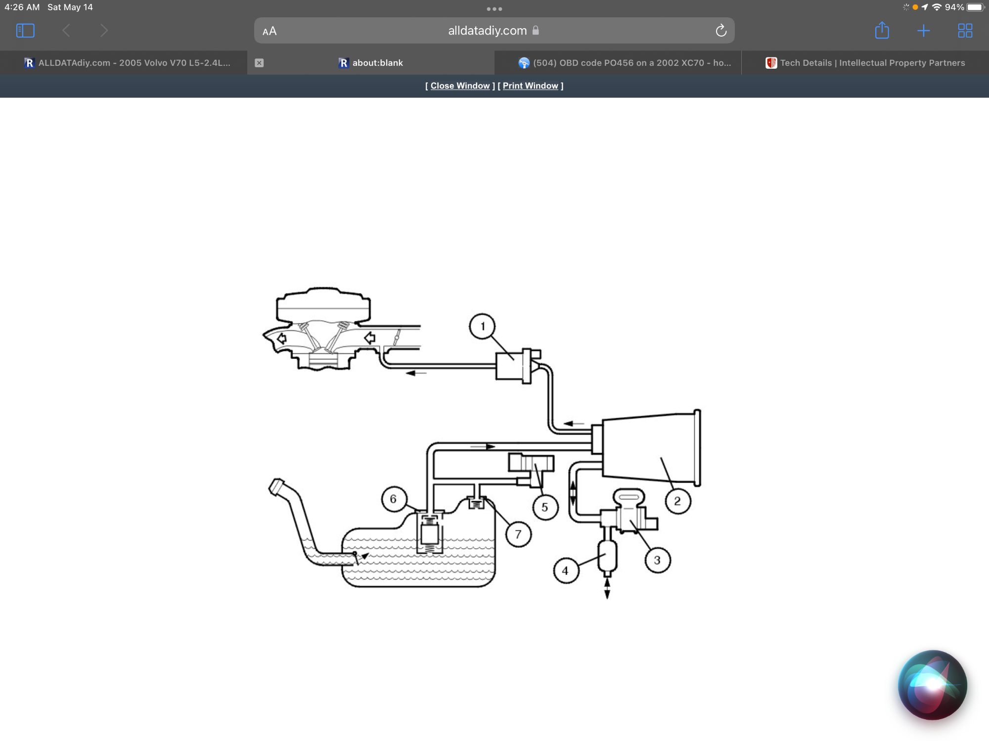

Hi guys,
The 2004 V70 with 128,600 miles developed a P0456 code (small EVAP leak).
Gas cap seal is intact.
Does anyone have a S60 EVAP diagram? I just want to understand the difference between these 2 valves...

If it shares the p2 platform evap, here it is…
- 3968658E-83BD-456A-8190-64BD10D498FF.png (546.38 KiB) Viewed 832 times
