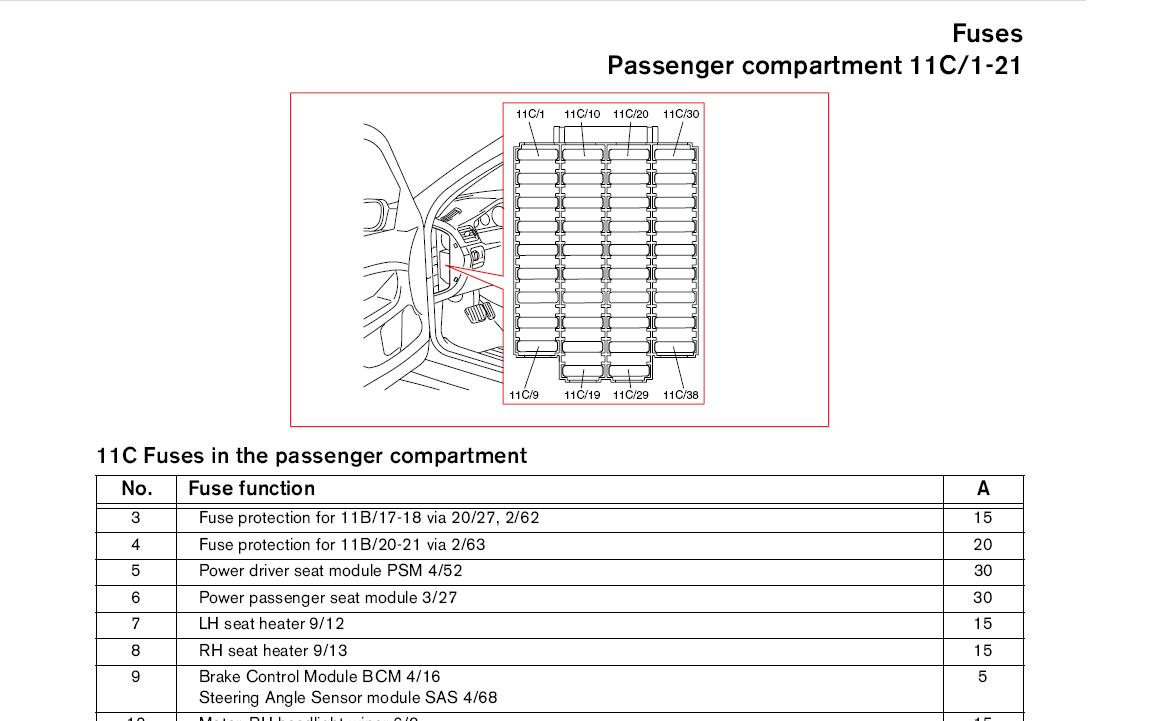

Did you check the fuses in this fuse block?

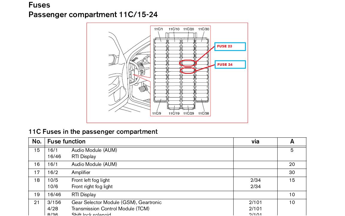

Make sure you check these two fuses:

Thank you I did check them and they were OK, but I will replace them today and will see what happen, I will also disconect the battery for a while.

Just to let you know I did check and replace the above fuse and it still does not work I even disconet the battery for about 20 minutes, with the same result. Do you know if there is a seconds place ther would be second fuse .
