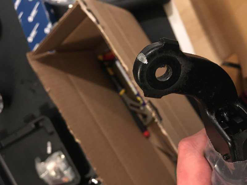

Sorry in advance for bumping a 7 year old thread (!), but I just replaced the rear wiper arm on my 2002 V70 XC and this thread was very helpful!
Mine also wouldn't come off after removing the nut. Started in on it with the dremel after being unsuccessful wth WD40.. Before I made it even a 10th of the way through, the vibrations loosened it enough so I could remove it. Hurrah!
Photo attached if it helps anyone!
