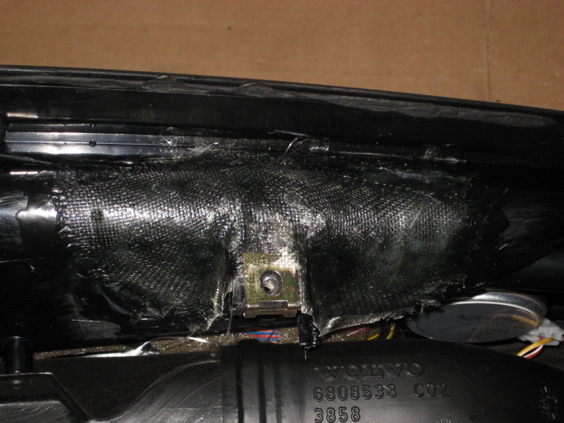

The glue I used to fix my dash is Loctite's Professional Heavt Duty Epoxy (5min), from Home Depot. It seems to hold everything together well, at least better than the "plastic weld".

"Most plastics, metal, glass, stone...etc", I found a bit tricky using that epoxy on ABS, which has to be cleaned by paint prep and sandpapered. I did use fiberglass cloth to repair dash, it turns out great, the fiberglass resin melted the fiberglass with the ABS formed a very strong layer. But if the repair area is very small I dont see how it would work. GL!
