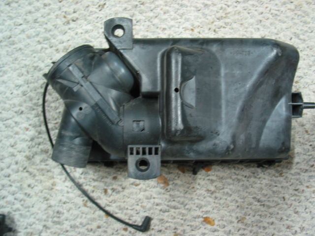

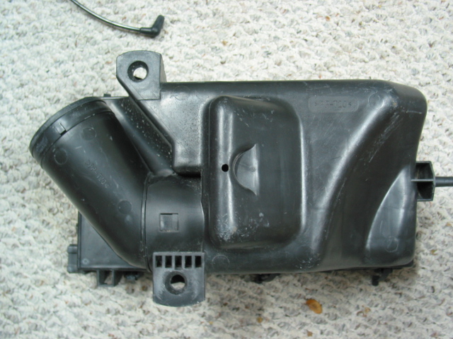

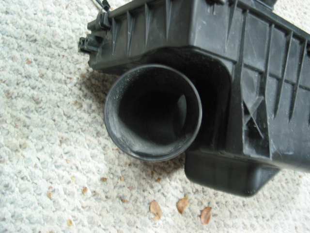

this is for everybody trying to figure out how to improve airflow on a NA850. I found the lower portion of an 850 airbox at a local self service parts yard. It doesn't have any of the pre-heat mechanism at the intake portion of the box and nothing else to interfere with the airflow, otherwise it is identical to the one on my 97 NA. It was laying on the ground near 93 thru 96 850's, but I don't know which one. Hopefully someone can identify what model it came on with these part numbers and the pictures I have attached. Part number on my 97 airbox is >PP-GF30<, on the unrestricted one it is >PP-T20<. If you figure it out please post to simplify for everyone else.
Andy

Nice find, don't know which car that would have come from. More then likely a turbo 850.

Wish I could find a box like that without the flapper for my V-90. The pre heater is a PITA as mine has a bad actuator and I had to cobble up something to block it open on the cold side. That box won't add any noise ( like going to a K&N set up will) + fixes a real issue for those of us in warmer climates with these cars. Thanks for posting the find bro!

that air box bottom is from any turbo 850. I got one for my friends 5 speed 850 from the junk yard.

Actually you don't need the whole box part. The intake snorkle clips into the box. I found a damaged box with a good snorkle. I got just the snorkle (for free as he didn't know what it was). I swapped out the dual inlet for the turbo one and installed a K&N replacement filter. Runs great!
