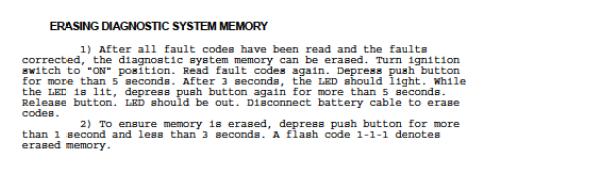

Hi All,
Just got this car from an older gentlemen, who blew the headgasket, and did not have time or money to replace it nice clean car. Replaced head gasket and head, and timing case cover. Check engine light on, read codes, wrote down;tried to clear codes to see if they are leftover from previous problem, or if I still have additional problems. Must not be doing this right please can I get some help with this, I already love this car it rides so nice, and I want to take care of it. Want to clear codes take it for a ride and see if I come up with light on again and if codes are the same so I know where to start. Thanks for any advice you can give will be greatly appreciated.

You don't say how you are trying to clear the codes but this is how to do it:
If you still have problems let us know.
