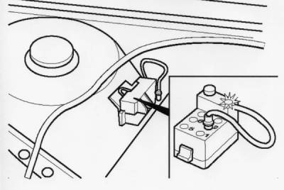

Usually poor idle when cold is not the injectors. It is more likely to be one of the sensors that supply the Engine Control Unit (ECU) with data to keep the car running properly.
However, before going too deeply into that, your car is fitted with an On-Board Diagnostic (OBD) with which you can read any fault codes that the system may have stored. If fault codes are present then it is a good start for diagnosis. The Data Link Connector is mounted on the strut turret and looks like this:
The attachment tells you how to use this very handy tool.
460 OBD.pdf
(599.14 KiB) Downloaded 402 times
Give this a go and see if any codes are stored. Post back for help if you need it.
