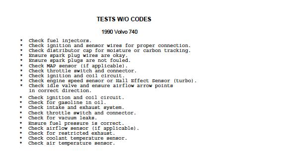

Have you checked for Diagnostic Trouble Codes (DTC)? This is a first step in diagnosing these vehicles and can be done following the instructions for the OBD in the announcements at the top of the forum.
If no codes are stored there are several things to check:
