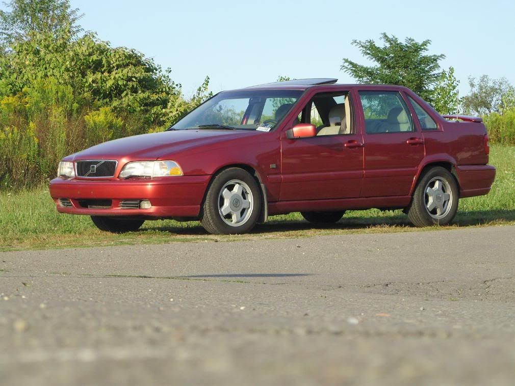

Post by tjts1 »
Yes you can.
RWD wheels are cheap and a lot of people use them to mount snow tires. Yes there is a difference in offset but you'll hardly notice it. Your 2006 has bigger brakes so make sure the diameter is big enough to clear.
