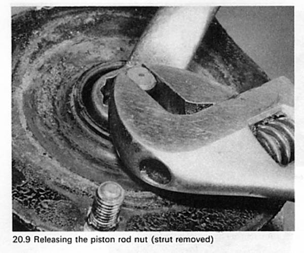

I have the parts to rebuild my struts. I just do not know how to remove the top nut without the #5036/5037 Volvo tools needed- see p.28.
Any suggestions?

I have changed a number of struts on various models of Volvo and other makes and didn't know I had to use a special tool. I use the sockets and spanners in my tool kit.

Do you mean I can use a 15/16 socket to take the top nut off? How do I use the crescent (spanner) in conjunction with the socket?

When I have dismantled struts I have removed the whole assembly from the car, removed the spring and used a ring spanner on the nut whilst gripping the piston rod with an adjustable wrench.
Picture courtesy of Haynes:
