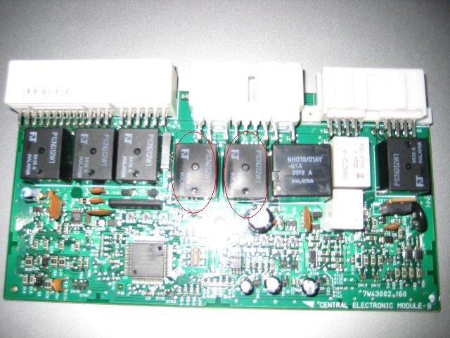

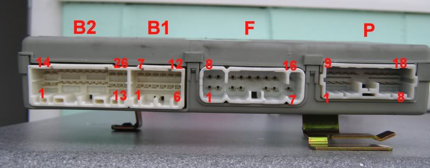

Ok, well I finally figured it out, know I just need to fix it.
It is the CEM(Central Electronic Module), I hit it a few times and moved some wires around and the lights came on.
I found 1 bad wire (so that could be it) or it could be the relay inside the CEM, which can be replaced. I found a couple of pic online I am attaching, but will take my own when I fix it.
A CEM from Volvo is $507, plus VOLVO has to program it. If you buy a used one you might still need to get it programmed depending on the options you have and the options the car it came out of have, so replacing the relay is good if you know how to do it.
Here are the pics
Here are the pics

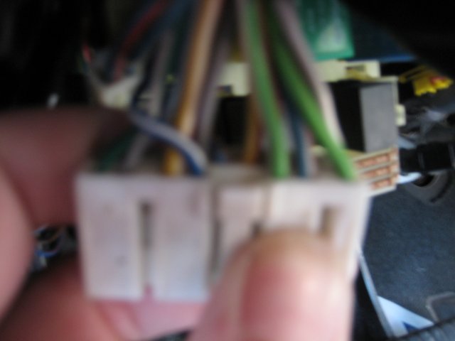

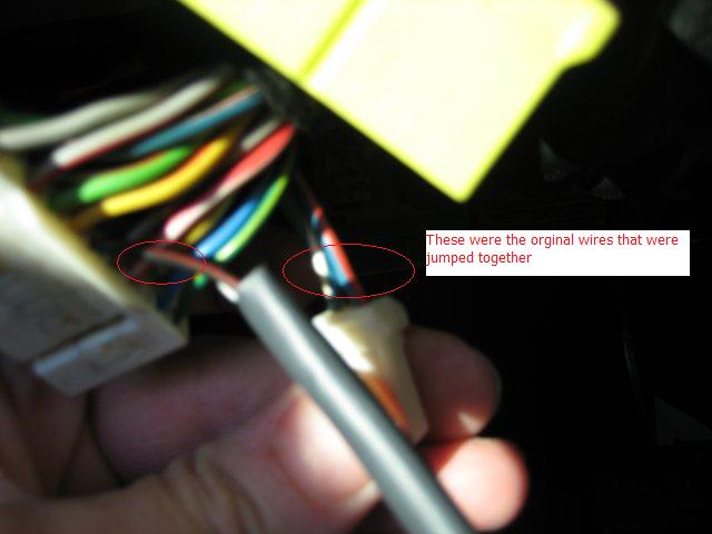

The saga continues.
I pull out the CEM this weekend, also looked at the bad wires, took some pictures (not great pic my camera was acting weird).
First about the CEM. You can see in the pictures that both (left and right) are shot, you can the bow on the top from were it overhead and bent the plastic, so I know these are bad. Still trying to source the relay, all I have found so far are companies that sell them wholesale, waiting on few emails to see if they can just send me couple. I'll update more after I get the parts.
Now about the wiring. I am not positive because I do not have the wiring diagrams but I think one of the previous owners blew the first relay and wired (jumped) that light to the other so they did not have to replace the whole CEM. That seems to have overloaded the second relay and wiring, burnt the patched wiring pretty good. I repaired this wiring for now and left it wired as i found until I can confirm that this is the case.
Anyone have any wiring diagrams? Know where I can buy them? I have pictures of the connector and the 2 wires that were jumped together.
Thanks.
Thanks.
