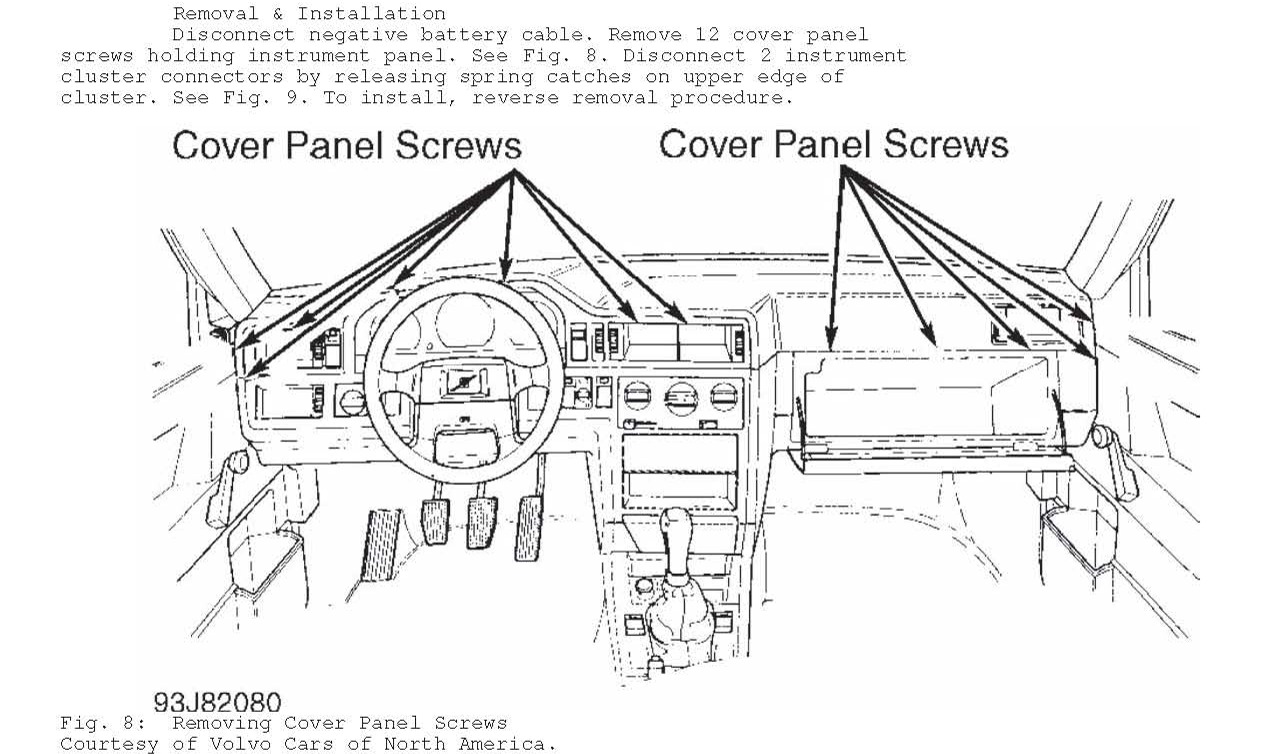

This cover is beyond glueing or velcro-ing it down & looks like hell. I looked at the service manual for disassembly - it looks like only 12 screws all easily accessible & the cover is off. Before I thought the entire dash had to be removed, which would have been a deal breaker. The local Volvo dealer wants $800 for a new cover installed, which is also a deal breaker.

This is how the manual says to remove the cover & instrument cluster. Looks easy, but I have to admit I haven't done it yet.

COUGH COUGH! I WANT YOUR MANUAL!!!!!!! lol..
where is this at? links please? lol im going to tackle this this weekend to re seat my dash.
and btw. can you post the figures it is directing to..
Jim-1995 850 wrote: This is how the manual says to remove the cover & instrument cluster. Looks easy, but I have to admit I haven't done it yet.

I searched this site & found this thread:RobTheModd wrote:COUGH COUGH! I WANT YOUR MANUAL!!!!!!! lol..
https://www.matthewsvolvosite.com/forums ... 8&start=98
This is the download link that works:
https://www.matthewsvolvosite.com/downlo ... vo_850.zip
What an awesome find for free!
??? I don't know what you mean. Each manual chapter is a separate PDF file & I posted that detail by converting it to jpeg & cropping out everything but that section, and uploading it. May not be the most web savvy way but it worked!RobTheModd wrote: and btw. can you post the figures it is directing to..

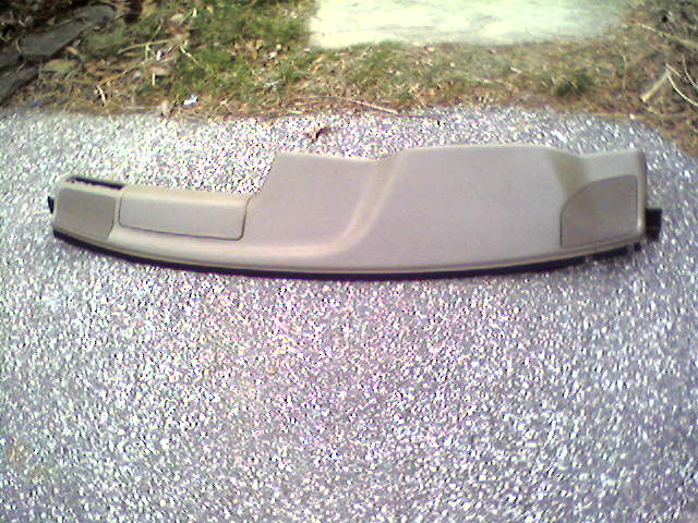

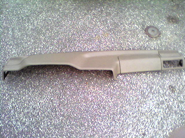

Well, I received the new cover, now to find time to install it! I'll try to document the procedure.
Jim
Jim
- cover panel removed 2.jpg (79.42 KiB) Viewed 1251 times
- cover panel removed 1.jpg (78.76 KiB) Viewed 1251 times
