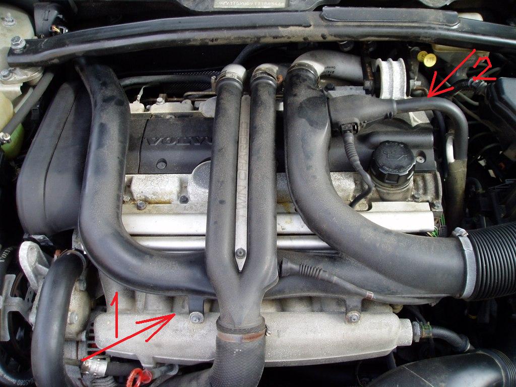

hello vegas,
i looked around the engine today and this is what I figured.
I am using your picture to illustrate.
The front of the engine looks clean, no leaks. (Arrow 1)
The back side of engine where I point #2, I see some oil around the pipes below the upper mount. I think this is where the leakage is.
Can you guess what it is?
Thanks...
Thanks...
- s80.JPG (146.69 KiB) Viewed 3546 times

Umm. Nope. I give up. What is it?neworleans wrote:hello vegas,
Thanks...
