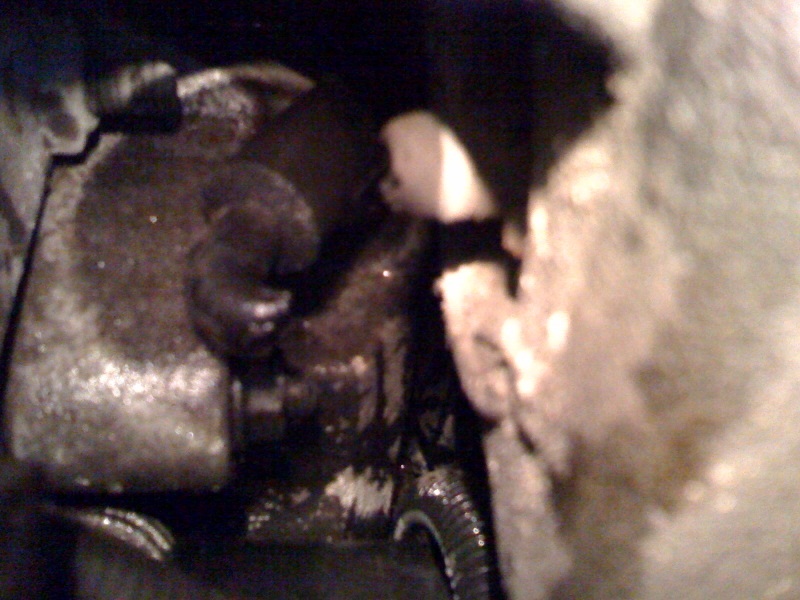

OK pretty sure I I found the issue..Looking at other threads I found that a lot of cars throwing this code had a broken vac pipe on the inlet manifold, front of the engine near the power steering pump and thermostat. Sure enough mine is broken
So the question is....What is this pipe and does anyone know the P/N. I have VADIS but to be honest I'm not having much look getting a P/N for it. I thought it might be a PCV pipe, but looking at the PCV system diagram on VADIS that appears not to be the case...

Well I went to pull the elbow off and the plastic snapped off about 4" back. Doing the PCV shortly so ill tend to it then. Got rid if the code though. Took the cap off the new fuel filter I put in the T6 and plugged the leak on the inlet manifold. Twill do for now.

I just wanna add that when your air intake pipe starts to looks like this...
You need to clean or replace that pcv nipple. When its clogged or has a leak/rip it deposits this oily residue that normally goes into the pcv oil trap box. I too had that oily residue there, and when i replaced breather tube i discovered the tube/hose had ripped apart.

+1 to PrestigeC70's comment.
That line looks ugly. My bet is that the PTC is completely clogged but the intake snorkel will likely be destroyed if you take the line off of the PTC to clean it.

Yeah, I actually cracked the darn tube thing right at the bend in the pipe getting it out along a line that already appeared to be there. I was able to find a junk one for $5 as opposed to paying the ridiculous $100 for a new one. Curiously, someone had already ripped off the PTC valve, and left the rest of the tube in that 850
My car ran much better after I fixed that tube and the rest of the PCV system...well, until the cam seal blew out and I freaked out and thought it was the RMS
