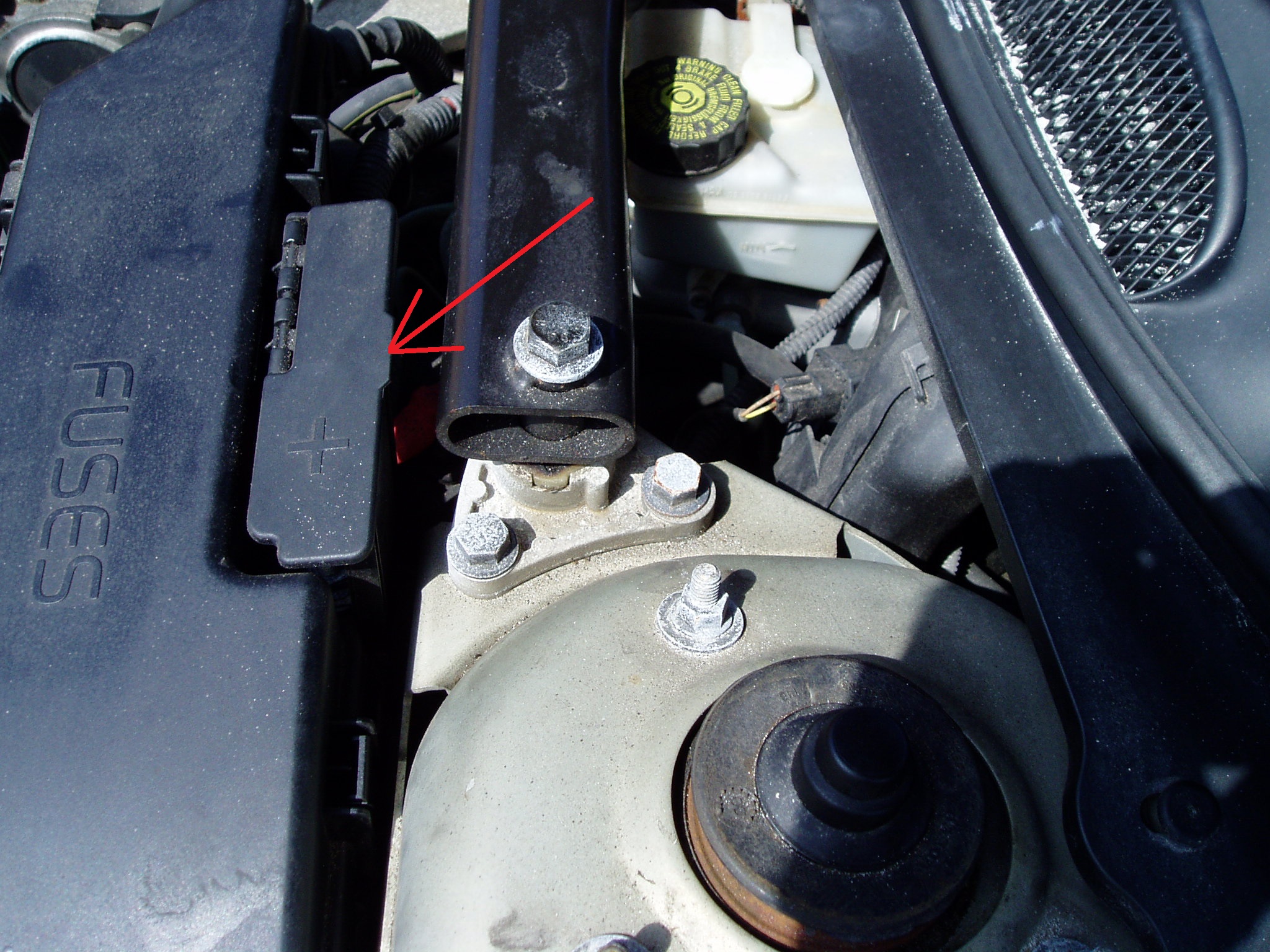

Post by vegasjetskier »
You should see something like this behind the fuse box under the hood. Flip up the lid to expose the positive connection.
Connect the ground (negative) lead to the engine lift bracket by the alternator.

Post by crusty »
Ok thanks looks like a no brainier I'll get my light and charger and go out and open it up. thank you so much
