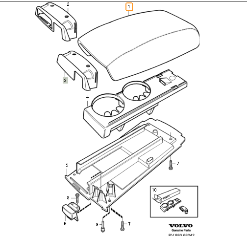

Has anyone replaced one of these?
Are you in possesion of instructions?
It looks as if it should be simple. Everytime i think that...........
thanks in advance

Hopefully the attached part diagram will give you enough information to do it yourself (I've never done this). Part # for the cupholder kit is 9499406, it's ~$50.
- 70 series cupholder.PNG (68.52 KiB) Viewed 1315 times

thanks
looking for a bit more info
screw sizes etc
i will find it somewhere and post when i do.
or post how we did it after installation.
it looks as if there is a screw or clip on the trunk side of the console.

Not Rocket Science...It IS very simple.
Get a Torx bit kit or a set of Torx drivers.
(You're gonna need'em sooner or later anyway)
Open the lid, remove the screws at the hinge.
Flip the cover over and disassemble.
It's all pretty straight forward from there.
