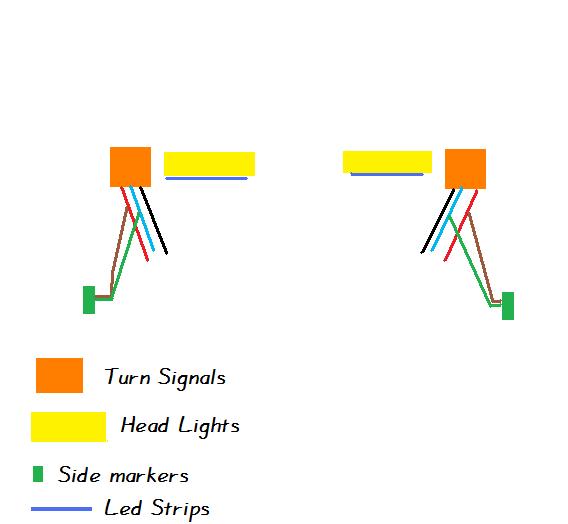

Anyways, heres my lame attempt at a wiring diagram.
- Wiring diagram.jpg (17.83 KiB) Viewed 1475 times

LED's draw next to no current...the effect on the battery will be negligible. Of course the preferred method would be to hook into the ignition switch wiring that the rest of the car runs off of, but that would mean yanking wires out of places you really don't want to mess with. As long as you have a hot wire into an actual switch that you can cut on and off directly, there will be no drain on the battery when that switch is off...you just have to start remembering that
I hope these LEDs you're installing come with some kind of resistor circuit wired into them already? I would think a kit would, but I've never used any such kit myself.
If you put 12V directly through one of the little things, they will light right up and explode with an absolutely terrific smell. I generally start with a 1K-ohm resistor (brown-black-orange and silver or gold bands) as a safe bet in a 12V circuit. It will vary depending on the color, but that should keep you from blowing them up. Here's some good basic reading: http://www.kpsec.freeuk.com/components/led.htm
Look around at Radio Shack or an electronics store or something. Even something as simple as a click button switch would work, just get something that can handle an amp or two of current through it.
As far as mounting them, I would think that tape would just melt. 55W headlight bulbs get HOT. I've inadvertently burned myself on my desk lamp several times going to adjust the thing. I'm thinking almost some kind of stitching or small mounting clips for those. I'll do some thinking on that.
DISCONNECT THE NEGATIVE CABLE BEFORE YOU GO ABOUT DOING ANYTHING! I'm sure you're not an idiot and know that, just warning you from personal experience
. 590 amps or whatever your battery puts out through your body will give you a right good kick to the heart.

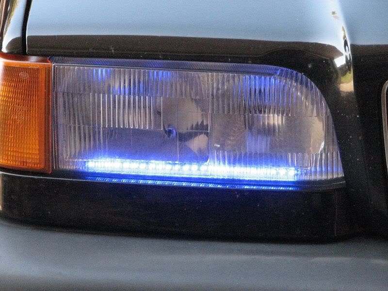

Came out quite nicely. Although very bright.. thinking about throwing a resistor on it to dim. possibly 500ohms to 1k.
Aswell as changing the color to white since blue is illegal. id like to be able to run them more often then just shows.
anyways, heres the photo.
I would have posted earlier but ive been waiting for a re register email due to email change.

Ran it all to this
Ill post a small write up if anyone wants to do it here later today.
this can be done by one person, but two is faster.

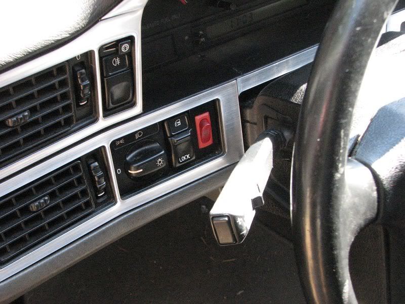

LEDs look nice, good job. You can get a real 850 switch from ebay or a j/y and use that instead of the red one... MIJ did the antenna down switch mod and used a real switch for it.

Was thinking about doing something like that.matthew1 wrote:Upload's fixed.
Any switch that would be perfect for this job?
I like the illum switch because I know its on lol.
I never posted a write up because I need to hide the wiring more, Friend did a great job running it where he did, but I want to hide it. maybe feed it thru the wheel well and up under the battery like I did for side markers.
