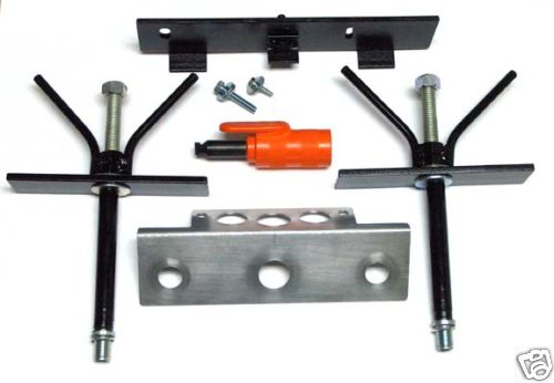

I have uploaded the parts that I had ordered to do this job. I am putting it in per the instructions that I was given. There is only 1 way it will go in.

The two Y-looking things pull the cam cover down onto the head. They don't lock the cams. The orange gismo blocks the crank - if you used that the crank shouldn't have moved. The black thing at the top looks like the cam locker. Did you use that?

I told you wrong on one of those post. We have not installed the Camshaft yet. He has the head on and bolted down.
We know that some volvos don't time TDC on #1 but we are not sure if this one does.
He wants to verify the postion of the crankshaft because the tool is not stopping at TDC on #1.
