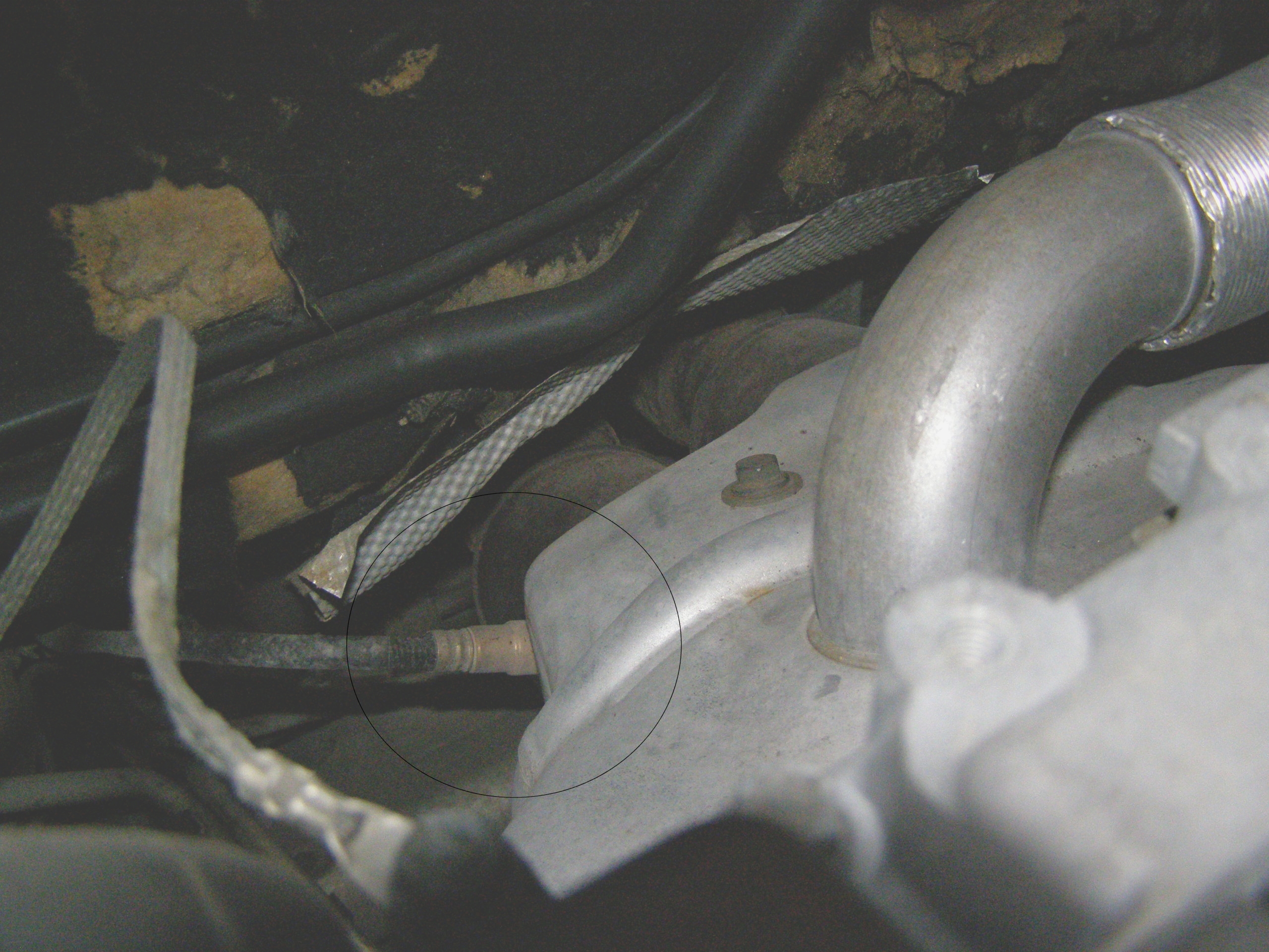

I have a 2000 S80 with the 2.9 non-turbo. I am looking at Vadis to see how to change the front o2 sensors. After taking a look at my car, I think my o2 sensors are not where Vadis shows. I think they are located right at the heat shield that is on top of the exhaust manifolds. (see pic) Does that look like the o2 sensor to anyone else? There is one just like it on the other side pipe.
Does this look like an o2 sensor.

Yes, that is one of them. The other is on the other side. Remember to remove the driver side tire to gain easier access to the connectors.
