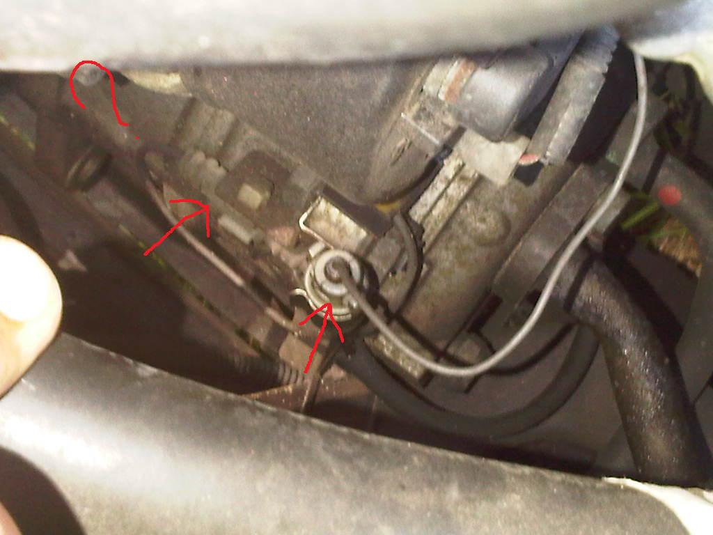

I think I have finally figured out what's going on with my A/C system. When I first bought the car the a/c would cut out and then never start again, did the ghetto clutch shim fix and worked perfectly till it started to really get hot outside. Now the Air cuts off about 10 minutes into driving and it won't start cooling again till the car has cooled off. I looked at the top of it and their are two things on it, and I'm not sure what is what. Also how do you bypass the thermal A/C Switch? (I read several other articles on here about it, but they confused me, any help would be great) Attached is a pic.

There are two wires that are associated with the thermal switch. If you want to bypass it just cut both of them and splice the wires together directly. Crimp style butt splices are quick and easy but I prefer to solder the wires together and then seal the joint with heat shrink.

Sorry I haven't replied sooner. I just got my new laptop charger in the mail so my comp has been down. I know how to splice the wires, I just am not sure where I need to splice them at. They seem to be coming in and going several different directions.

In the picture on the original post the bottom arrow points to the thermal cutoff switch. Snip the wires on both sides of it and then splice those wire together. It may or may not fix your underlying A/C problem if it is a clutch gap or R-134A charge problem.

Thanks, so as the bottom arrow indicates that cylinder object, I cut the top wire and the bottom wire and then splice or solder them together, correct?
I'm honestly not sure which problem it may be. I will try and get my hands on that A/C Relay first before I start hacking wires. Sometimes I can drive for hours and the A/C will blow cold the entire time, other times it will work for 15 minutes quit. If the a/c switch is shut off it will work again after about three minutes to five minutes. Sometimes it does this all day, sometimes it doesn't happen for a day or two. It's kind of stumped me. This problem didn't show up till a few weeks after I had the unit charged, as soon as it started happening I took it back and they checked the freon. When running it was at 40 PSI.
