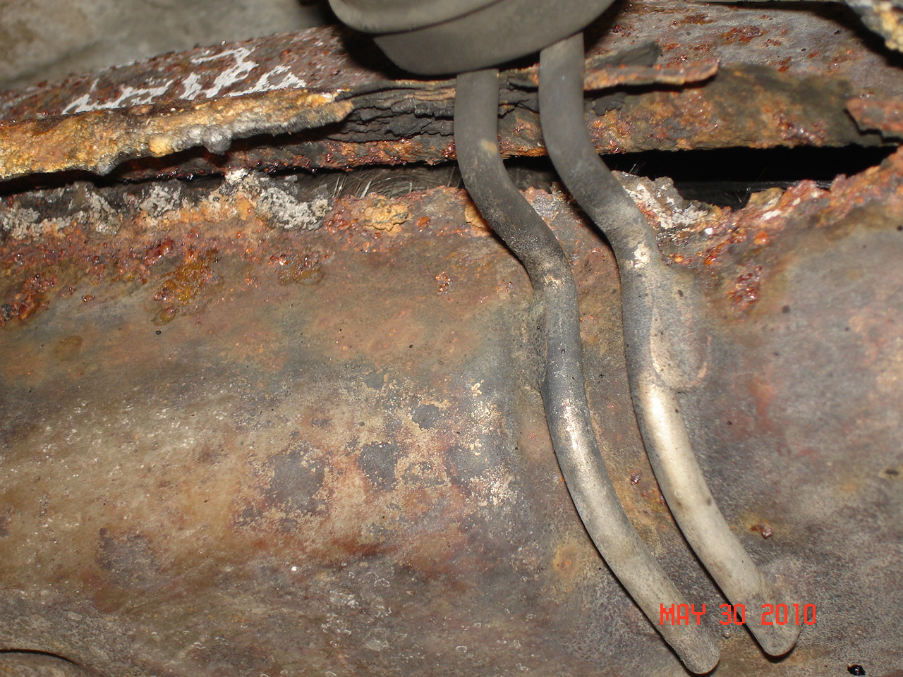

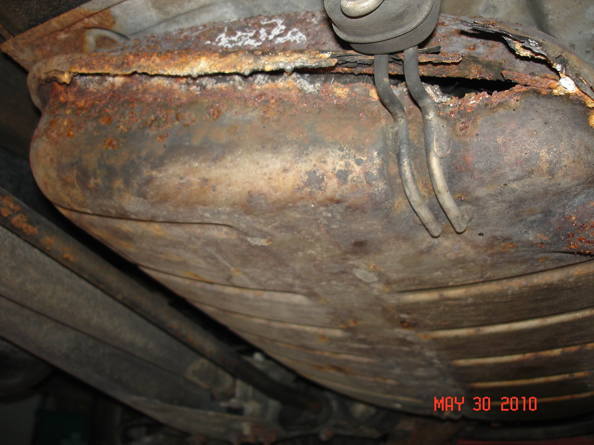

I know that quite a few people are going to respond "just buy a new muffler" but taking my
car to a shop is as comfortable for me as buying a car is (dealing with car salesman). You're
thinking I'm a cheap SOB. If you are around when my wife is present you'll wonder if my middle
name is SOB.
A few years ago (at least) :lol: my Volvo guy tells me my muffler has a long slice in it and needs
to be replaced. I think it was going to be $400 or so (plus the extras when things go wrong).
I ask how long before it must be replaced. He says a while (big mistake) so here I am with the
same bad muffler.
The long slice in the muffler does not generate a lot of noise. I mean that it doesn't sound like a
car that really needs a muffler. So I've held off for a few years but now realize that I may be
able to do something myself, if only to reduce the noise, that is cheap and effective.
I was planning to clean up the rust and JB Weld a thin piece of sheet metal to fill the crack.
When I was browsing in Advanced Auto Parts yesterday I saw this putty like substance
that is actually intended to repair cracks in the muffler/exhaust system. I'm thinking to myself
that this can't hurt too much.
Has anyone tried any of these putties for repairing the exhaust system?
What can I use on the rust (rust inhibitor) that will not result in a fireball when I go for drive?
Is there something for rust that will hold up to high heat?
Here are a few pictures:
Crack in Muffler
Crack in Muffler
Closer View
Closer View

hmmm it looks too far gone i would change it
had the same and i just replaced the whole thing
if you want to gamble try sanding out the rust and welding if the metal left is too thin its not going to work or fill it up with muffler putty but i fear its not going to last its a very temporary fix
you can get the muffler part for about 200$ and do it yourself its not that hard shop around..
metal seems to be too far gone

JB weld will hold if you do it right, meaning clean the up the best you can and use proper amount to fill slice. Ive used that stuff on oil pans and people I know have used it on buses and big trucks. You already know that you should replace but I understand your trying to fix cheaply so I would swear by JB weld if applied properly.

That's a big one but it IS possible to repair it (for a while at least)
FURNACE CEMENT
Follow the instructions and please grind off the rust before you start and after you apply it, IDLE the car for at least 15 minutes to cure the cement, do NOT rev the engine up, it's not cured and you could blow it off until it hardens in 10-15 min.
IT WORKS!
