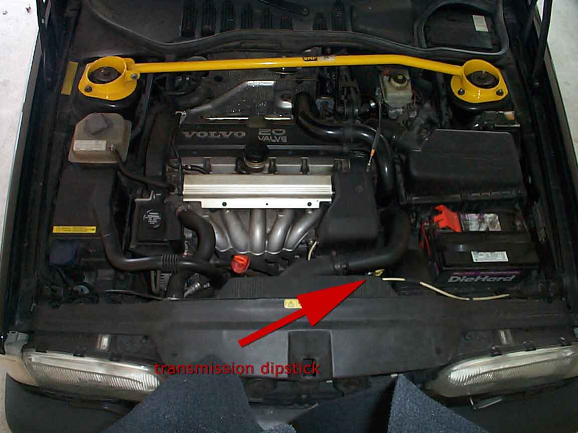

Volvo 850 transmission dipstick location
Transmission fluid dipstick should be located very close to that of the 850, shown above.

Matt I love that yellow sway bar. It's aftermarket I assume? I was going to look for one but I think it would block my fuse box!

yes there is a tranny dipstick in the area where Matthews diagram points to. It's a short yellow dipstick, but definitely is hidden under one of those hoses. Just look in that area with a good light and you'll find it.

Fendar wrote:Yeah u won't find a dipstick. The fluid is enclosed.. Does ur manual say anything about the fluid light? I'd check mine but the wife stole the c70 for a few hours!
THE FLUID IS NOT"ENCLOSED", SO WILL YOU STOP REPEATING THIS BULL CRAP
THERE IS A DIPSTICK
The dipstick is approx ,where that picture shows, perhaps a little bit back further, you need to remove the air intake tube to easily get at it
