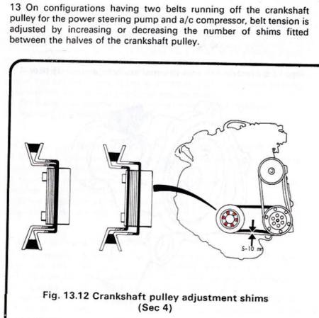

This is from Haynes up to 1986 models:
Crankshaft pulley adjustment shims1.jpg (28.8 KiB) Viewed 6859 times
There are six adjustment bolts around the pulley face as indicated by the red dots.

What year is your 240?...Prior to 1978 Volvo used a 2 cylinder York compressor that sat upright and looked like an ordinary air compressor...The belt set-up was as shown in the previous post and had the shims...There were 6 bolts for making adjustments...
Later they used the familiar round compressor and the belts are adjusted by moving the compressor...There are 2 locking bolts on the compressor mount that have to be loosened and then the compressor can be moved by turning the long 10mm jack screw that sticks up towards you next to the compressor...The locking bolts are hard to find and see and it will be necessary to remove the air cleaner housing to see them...They have a nut on the back so you will need 2 wrenches, one to turn the bolt and one to hold the nut...

Bill,

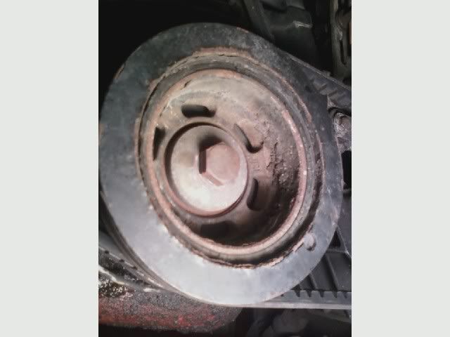

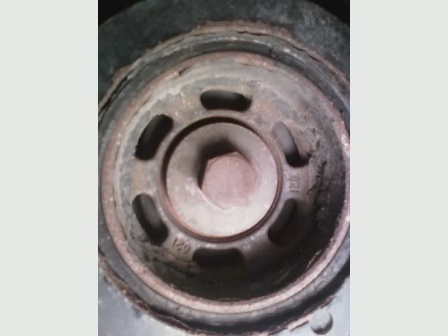

That's a very good diagram, but it still leaves me confused. Where are the bolts? Here is what my crankshaft looks like:
I see six holes, but no bolts.
Wait a minute ... now in the picture I see where the front of the crankshaft has a little opening where one can slide a flat-head screwdriver ... maybe this is the way to pry off the face?

Your 240 does not have the shim adjustments at the crankshaft pulley...The adjustment is on the compressor mount...If you had the shims at the crankshaft pulley, there would be no holes through the pulley...Instead there would be 6 10mm bolts aranged in a cirular pattern around the center of the pulley...
See my previous post...
