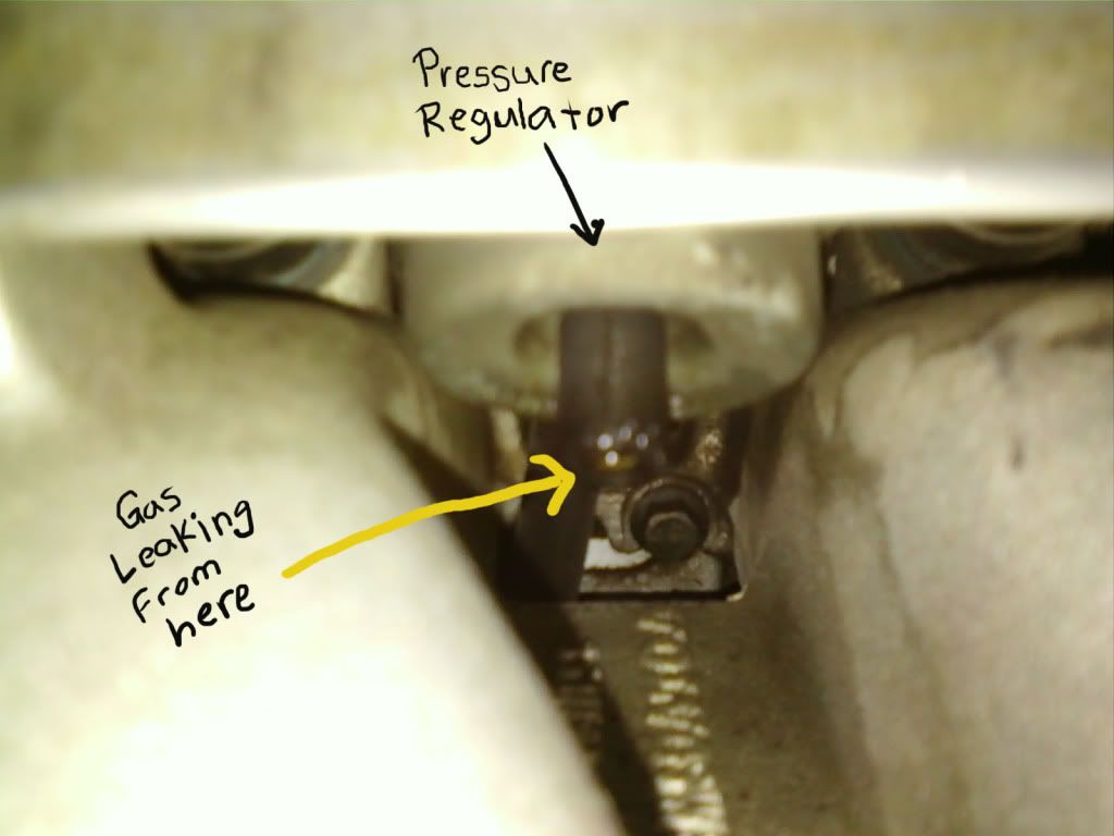

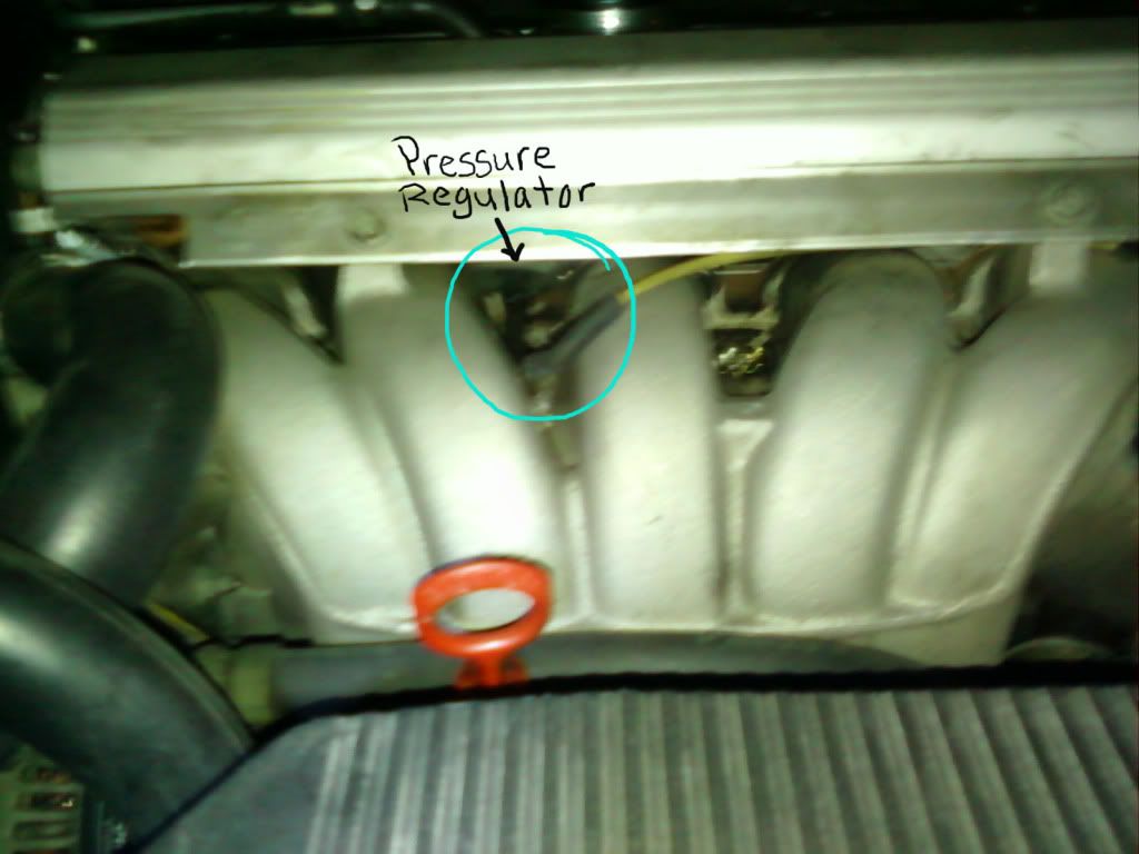

Hey guys,
Last week I noticed a sound coming from the rear passenger side of the car and it sounded as if there was a flow problem coming from inside the gas tank, similar to the sound of running water through a pipe in the wall. I suspected that the fuel pump was going, but I needed to wait until Friday to take it in to my mechanic. Unfortunately on Tuesday after work I go to start the car and it started but then died 2 seconds later. The engine will turn fine so there's no issue there, but then I noticed a very strong smell of gas. I looked under the hood for any leak and found that the yellow hose that connects to the pressure regulator under the fuel rail was broke, but leaking out gas every time I tried to start the car. What's going on here? Can i just replace the hose or is there something more serious here? See pics below for specs:

Your fuel pressure regulator is gone, I dont think it is repairable so that replacement is your only choice.

Avoid driving the car until it is repaired. It will run horribly rich and it can cause further damage.

Ok, but what about the yellow hose too? The hose looks as if it broke off and can't be pushed back on to the regulator once it's replaced. Do I need to replace that as well? And how would I go about cleaning up the gasoline that has been dripping and leaking on to the engine? Is there a safe way to do this in order to avoid the fuel catching fire, or will it be ok?

I really don't know of a good way to reliably cap it off. You can pick up vacuum caps and possibly get a small hose clamp around it but I don't know if it will hold. You will be trying to hold back 45 PSI. As far as the hard line goes you should be able to extend it with a short piece of vacuum line. If you can successfully cap it off you can drive it that way until you get the new regulator.

BTW, for that broken rubber elbow(connected to the regulator) you can either replace with another one or you can just use a piece of silicon hose instead. In addition, you might also want to replace that short piece of flex fuel hose between the hard fuel line and the regulator, since you will find the hose on the regulator side is impossible to take off.
