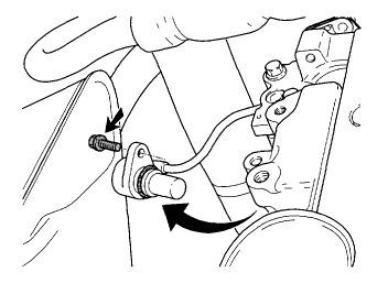

I wanted to do it myself, but couldn't find the darn sensor. Where is it? Pics?

This is probably the sensor, looks like it's on the back of the engine above the turbo. I wonder if it is just gunk and dirt on the hub, or a dirty sensor.
