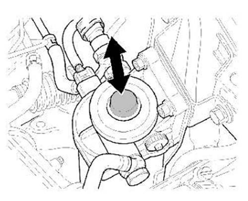

The fuel system bleeds itself during starting and running. However, to reduce the load on the battery and starter you can hand prime the fuel filter by using the pump on top of the filter. Keep pumping until you feel resistance. To get to the pump you may have to remove the fuse box but it is only held on by two bolts and can be moved far enough without disconnecting any wires.

I was looking for the manual pump and my car seems to be a different filter than the bosch or cav that I am familiar with. it also seems to be different to the diagram that you showed. it is a puroflux? filter system and there doesnt seem to be a manual pump to bring the fuel from the tank. I think i did not go through the correct procedure for starting from an empty tank. It started and then stopped and there is no fuel from the filter to the pump and it will not seem to self prime.

My mistake. I looked for the year and thought it was 2001. My wife has always said I was at least nine years behind. :)
