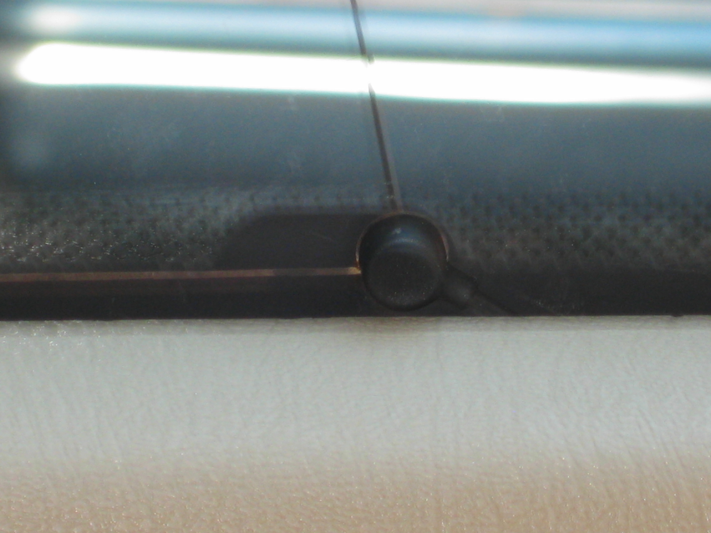

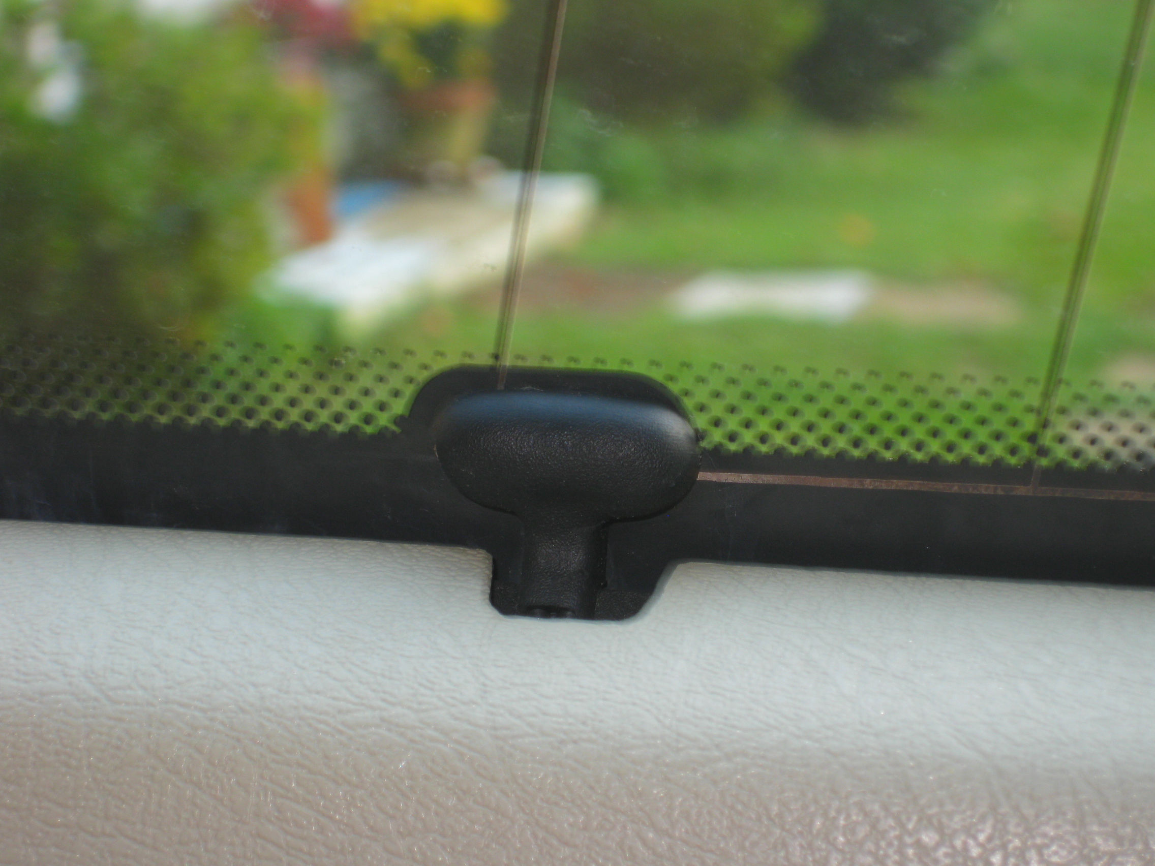

Here are pics of the connectors on both sides of the rear glass. Not sure what I'd be looking for here. Thanks.

A very likely cause is damage to the copper traces somewhere on the glass...Look very closely for a scratch across one of the foils...It could be anywhere on the window...Liquid repair material is available for repairing rear window heaters and it works for antennas...It has a high metal content and when it dries it completes the circuit...
If you find a scratch, first try bridging the gap with a screw driver or such while the radio is turned on...If you hear an improvement in reception, or extra noise, you have it pin-pointed...

The AM antenna on the window is a "loop" antenna...FM is less susceptible to interference and they usualy use the wire feed as a dipole for FM reception...If you have a personal FM radio that you use when jogging, etc, there is no antenna...They use the headphone cable as an antenna...
