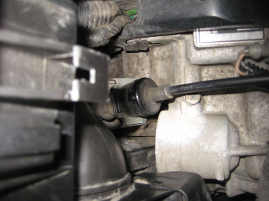

I also looking to see if there is any vacuum leak. So far, I could not locate any. But I found a line which I am not sure if it is a vacuum line or a electric cable. Can anyone identify what this line is in the picture? It is under the air box and above the transmission. Is it true that my model has no SAS, air pump, and EGR?

Someone said the cable is shifter cable. So, it has nothing to do with vacuum.
