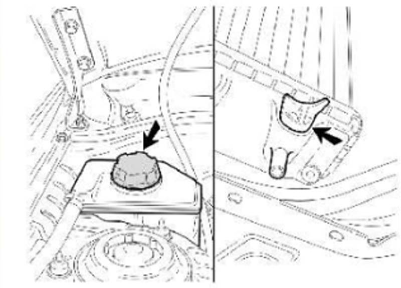

is anyone able to give very simple & clear instructions on how to empty/flush the radiator of a 1998 volvo s40 t4? eg where the empty plug is...

The drain cock on the radiator is at the bottom left side looking from the front of the car. The attached is the VADIS instructions for draining the coolant. Before starting work set your heat control to maximum heat so the heater will drain. Leave it on max until you have refilled the system.
To flush the radiator drain as in the above then remove the top and bottom hoses and flush with clean water, preferably using a hose pipe. Replace the hoses and slowly refill the system with coolant/water mix occasionally massaging the radiator hoses to prevent air locks.

Coolant is NOT a lifetime fluid, as some automakers would like you to think. It should be changed every 4-5 years or so.my manual says that "Normally, the coolant does not need to be changed." so I don't need to flush it out right? why would you want to?
Careful with the petcock on the radiator; they are known to break off on most of the other cars (5 and 6 cyl versions). I just yank the lower radiator hose and be prepared with your bucket for a large rush of fluid at first.

Antifreeze loses its properties over time so does need to be changed, as Justin said. As for flushing the system that is your choice. It isn't strictly necessary if you use distilled water in the cooling system but I always do mine when I replace the coolant and it is amazing how much rubbish comes out.

so i can place a bucket where it drains out, one that can hold 6.3 liters, and spray it when a garden hose to get all the "rubbish" out? and how can i legally dispose of the waste?

It's perfectly acceptable to pour antifreeze into a toilet on a sewer system.
You will probably not see 6.3 liters come out of the entire system - some will remain in the heater core, water pump, passages in the engine, etc. But go about draining the radiator and engine block drain. Fill the car with water, let it run through until the engine reaches operating temperature, and then drain the system again to get the crud out. Then you can proceed with adding your new coolant.
On the S70, there is an engine block drain to the passenger side of the car at the very back of the engine. I should think it's in a similar location on the 4-cyl version of the engine as well.

As in this and same on the S/V40:On the S70, there is an engine block drain to the passenger side of the car at the very back of the engine. I should think it's in a similar location on the 4-cyl version of the engine as well.
