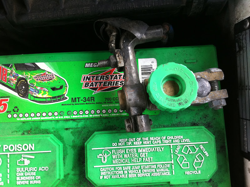

Bah. 3 years into ownership of my '97 855 and I'm still having this issue. That is, the battery seems to lose charge over time, even when driving the car every day. It has suddenly gotten much worse, now that it is cold out, to the point that unless I manually top-off the battery, or drive it every 24 hours, the car will fail to start. Battery is less than 1 year old, replaced once since I have had this problem (Interstate battery, replaced under warranty with bad cell- probably due to being fully discharged somewhat regularly, due to this issue). In the past I have more thoroughly checked parasitic loss, (see this thread), and while I may have an issue with the diodes in the alternator, I'm now leaning towards a bad battery cable.
Can you guys help walk me through testing these cables? Much of what I am finding in the archives is referencing the S/V70's. For example, I don't seem to see the B cable in my fusebox.
You can see from these attached pictures that the battery cables at the posts look awful. Suggestions? Am I on the right track? Can someone show me where in the fusebox I should see the other end of the B cable?

Based on the 80mA current draw you describe in the thread, the alternator is still suspect. Remove the main positive feed (12mm nut) from the alternator & check for the current loss. If it's gone you had still better replace the alternator or regulator.
Bad battery cables cannot draw current, as they are simply not completing a circuit. However they can lead to a battery improperly charging while the engine is running if they are corroded.
Once the battery is disconnected an ohmeter can measure their resistance. The earth is easy enough; find a good ground (such as the engine or chassis) and put your probe on it then connect the other probe to the end of the terminal nearest the battery. The reading should be less than one ohm. For the positive cables the same applies, measuring them at the battery terminal end and to the starter motor terminal and then the alternator terminal.

The secondary leads (both positive and negative) look awful. Remove the nuts and throughly clean all of the surfaces on the secondary lead terminals and the main terminal where they mate. I would also get rid of the anti theft switch on the negative lead and just plug the negative terminal directly to the post.
I assume that the lead going to the left from the positive terminal didn't replace the starter lead and the starter lead just isn't visible in the pictures.

Ozark Lee wrote:The secondary leads (both positive and negative) look awful. Remove the nuts and throughly clean all of the surfaces on the secondary lead terminals and the main terminal where they mate. I would also get rid of the anti theft switch on the negative lead and just plug the negative terminal directly to the post.
...Lee
Thanks Lee. I will clean up those cables and re-do the above test. The anti-theft switch is my current solution for the battery drain (related, but I believe separate issue - see above), and it works. I can leave my car for over a month and it will start when I return (a common necessity with my job).
Yes, the starter lead just didn't show up in that image, it goes straight down in the photo.
