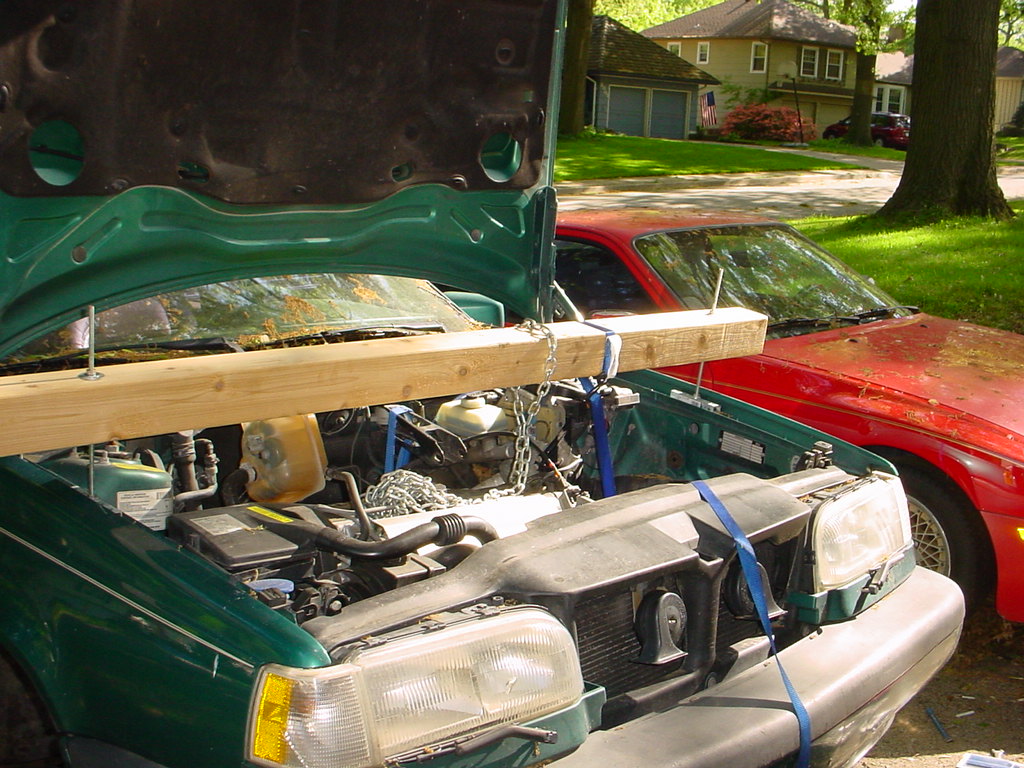

You will need to figure out a method to suspend the engine while you drop the transmission. I spent quite a bit of time at Lowes dreaming up a solution but it worked just fine.
Just avoid hitting your head on the 4x4 when you crawl out from under the car.

I noticed in this picture that your struts are still bolted in, and the wheels are on the ground. I thought for some reason the suspension had to come with the subframe, or atleast some of it.

You can leave the struts in but the axles need to be removed from the transmission to get it out. Once you remove the nuts on the ends of the axles at the hub you can swing the suspension out of the way once the axle clears the steering knuckle.
The picture is deceptive - the car was jacked up and on jack stands at that point.
...Lee
