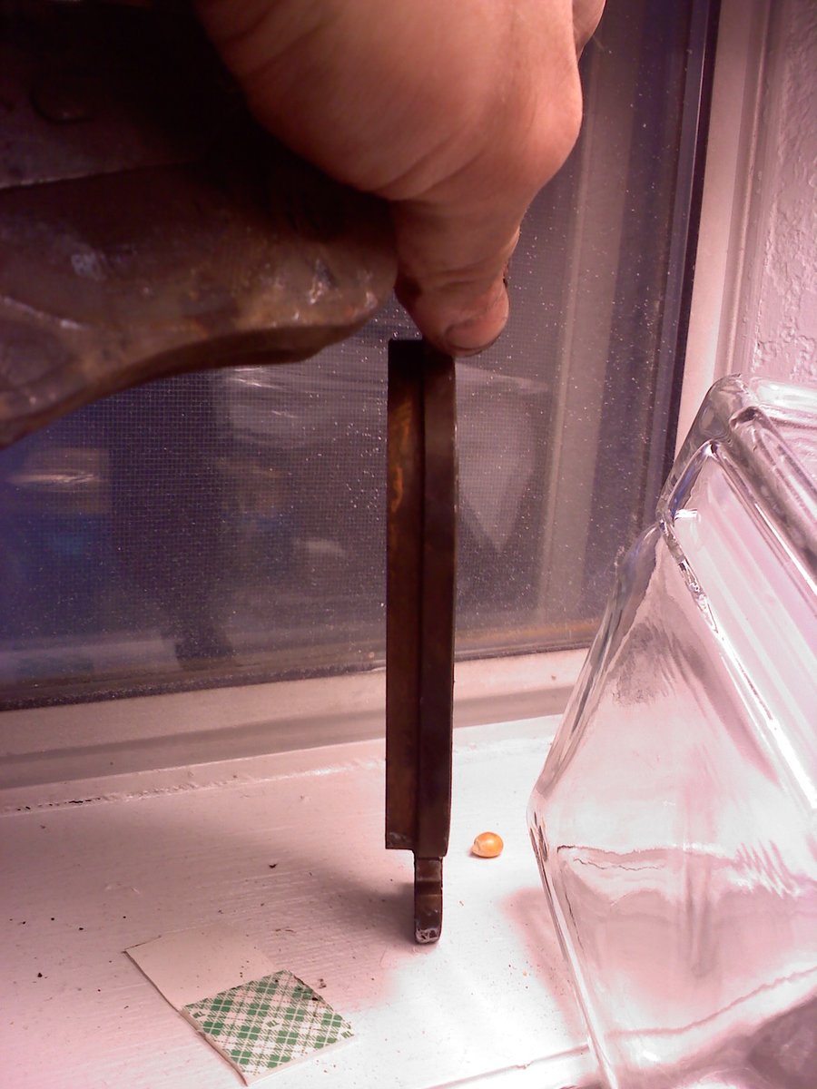

No, the factrory oem brake pads, front and rear, DO NOT have worn down brake pad warinings. If you do not know how much pad material you have, then it's time to take the wheels off and take a look. Thankfully, the factory OEM pads and most aftermarket pads are now bonded to the backing plate and not riveted, meaning you can wear them down to about 1/8th inch, but wouldn't let them get much thinner. When you do decide to replace the pads, I recommend Ceramic pads up front, and either Ceramic or Semi metalic in the rears. Most are available at Autozone, carparts.com, partstrain.com, fcpgroton.com (sponser of this website), and so on.

I had that much of the pad left on my fronts, and they squealed like crazy (those were the OEM pads with about 55,000 miles on them.)
I also recommend the ceramic pads - they grab better than OEM ones even when cold, don't make a lot of dust, and don't squeal. I used Akebonos and Zimmerman cross-drilled rotors.
