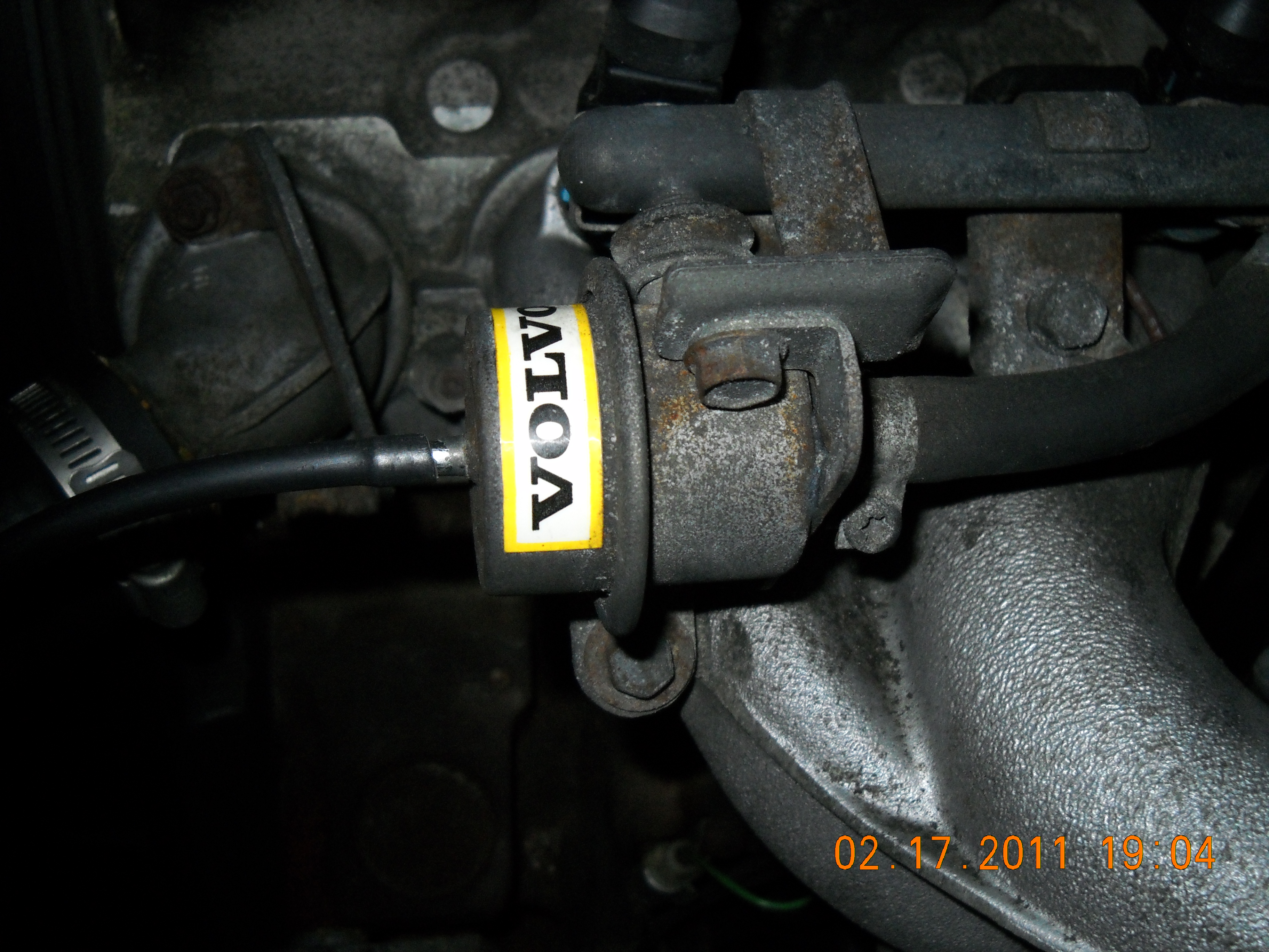

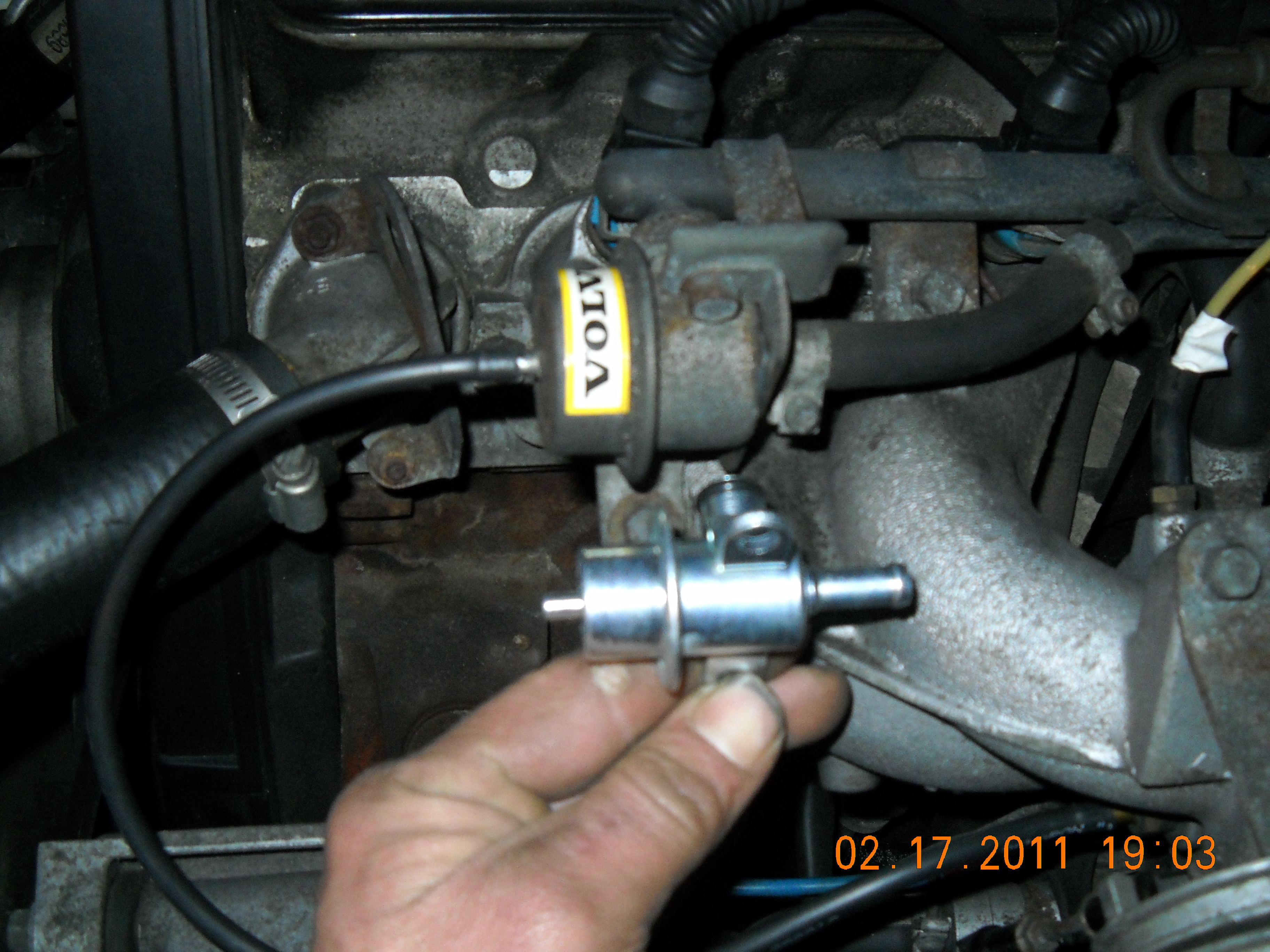

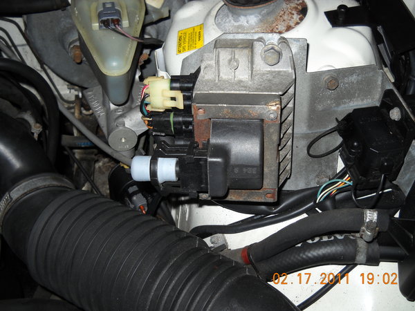

have a 92 740 wagon regina ignition regina emissions my fuel regulator died so i orderd a regina fuel pressure regulator through fcp and got one hafe the size spoke to the tec at fcp and sent him pics he told me its a bosch fuel reg.can this be emmisions and ignition regina fuel bosch does this mean i have a mut here :D ill try to post pics thanks for any advice.

bosch and Bendix FPR's are interchangeable.
You do have Regina/Rex fuel and ignition.
The parts can be mixed and matched in some cases. Initial R/R fuel system had Bosch fuel pumps.
Newer models have Denso parts on Bosch engine mangement cars.
Made to specification and interchangeable.
Actually that looks like the Bendix FPR to me. Bosch FPR of that style is dished inward on end and has a deep depression where vac nipple attaches.

thanks for the help put on a boschfpr and it worked thank god thats done.
