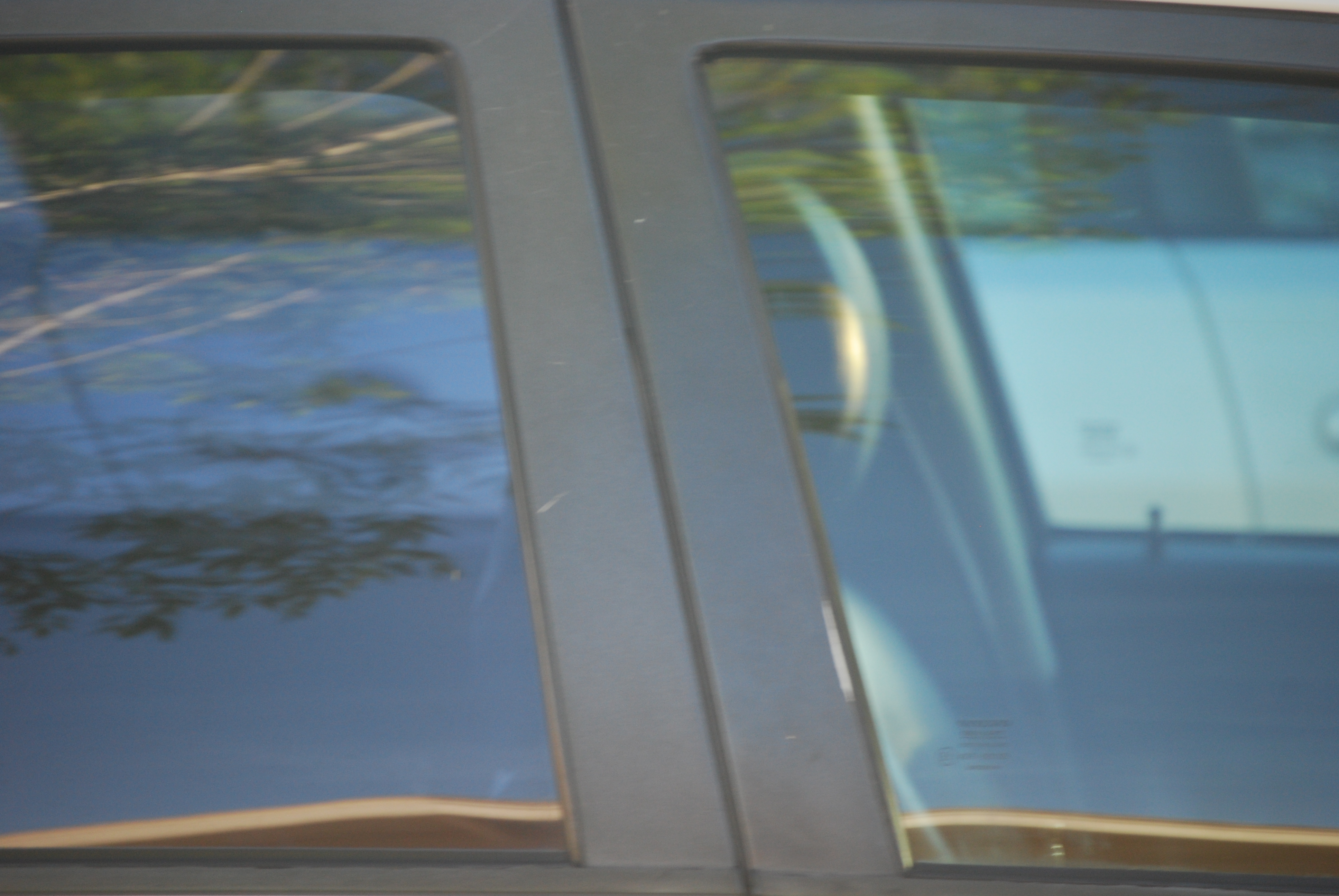

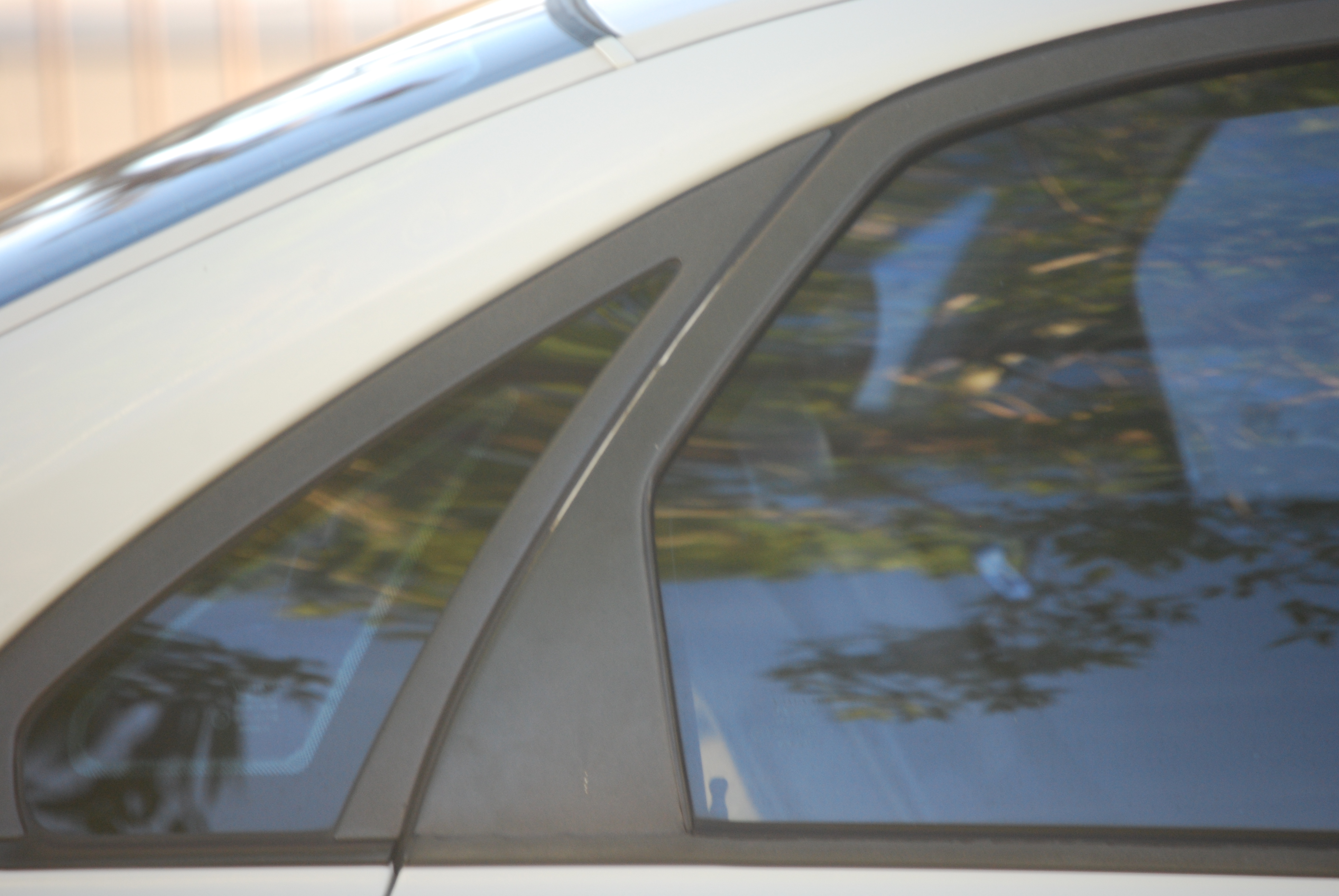

So the black trim is starting to peel around the windows. I was wondering if anyone has tried to take this off, as it seems that it's painted the same color underneath. Some of the S60's have no trim and just matching paint, and it looks a lot better. I've been trying to decide if I should do this or not :S Any suggestions?
This is just one part, it's all over on all sides :[

I think it's not so bad, yet.
Use a black marker (permanent) to mask it at this stage. When the situation gone worst (probably after a couple ot years...) you may think about some paint job.

It's just like a huge sticker, it's held on with some sort of adhesive, but idk how strong it is. :evil: I don't want to rip half of it off while the other half is going to be glued tight.

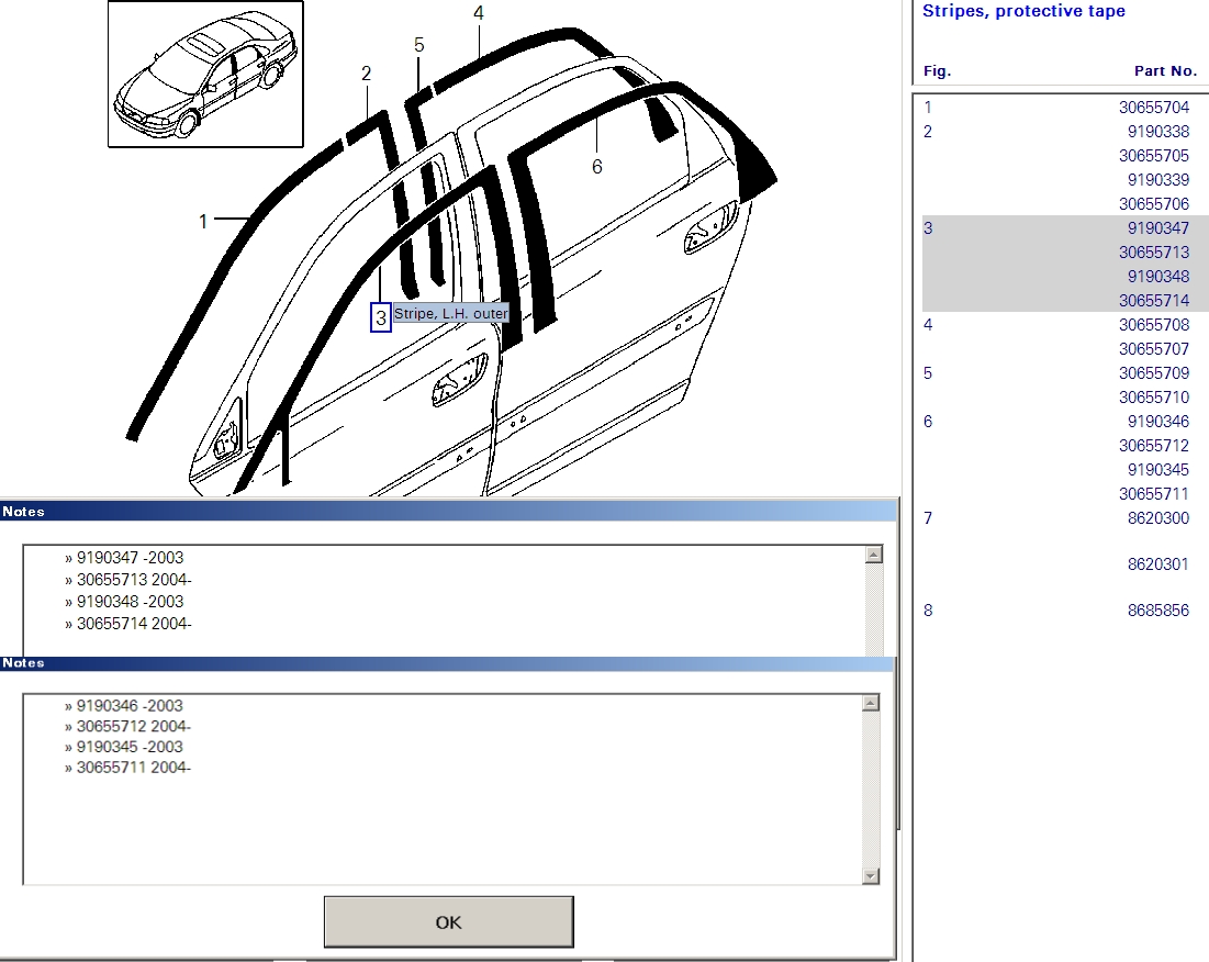

Uncle VADIS said:
Upper note is for front, bottom is for back stripes.
I'm able to check the prices online for the local bulgarian dealer, but i don't know about your dealer where you can make such a check...
