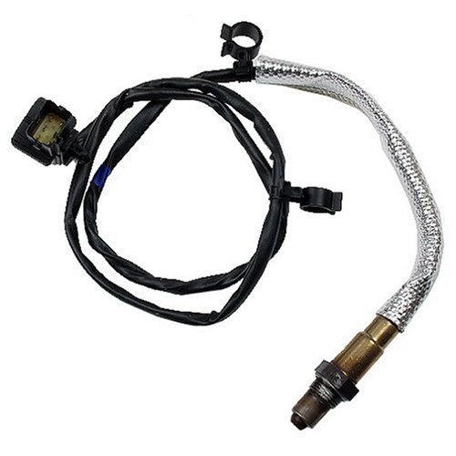

Hi
V70 turbo 2001
Repacing Frount O2 with a universal Bosh 15733
can not get electric clip (plastic clip that holds O2 wire to wiring harness) loose
It is at arms length on driverside . have been poking at it with screwdriver but can't get it loose
press down or pull up?

post a picture please
You will be cutting the wires. You can do this with the plug still attached.

Bosch 17070 looks like it has a clip on one side. You press the tab farthest away from the harness to release/lift the tab over the lock. Then pull
