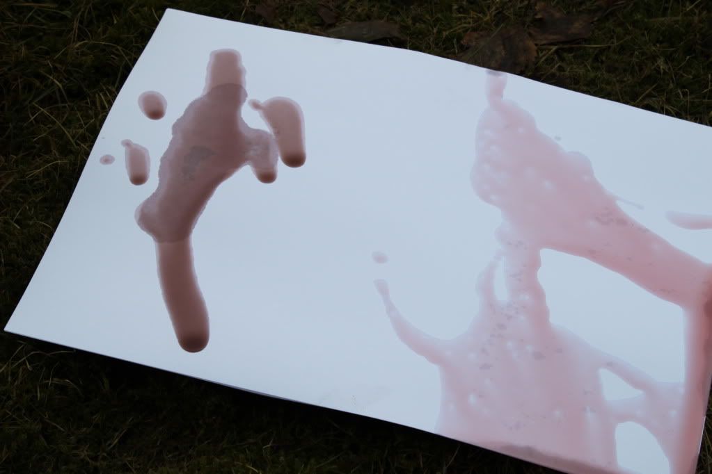

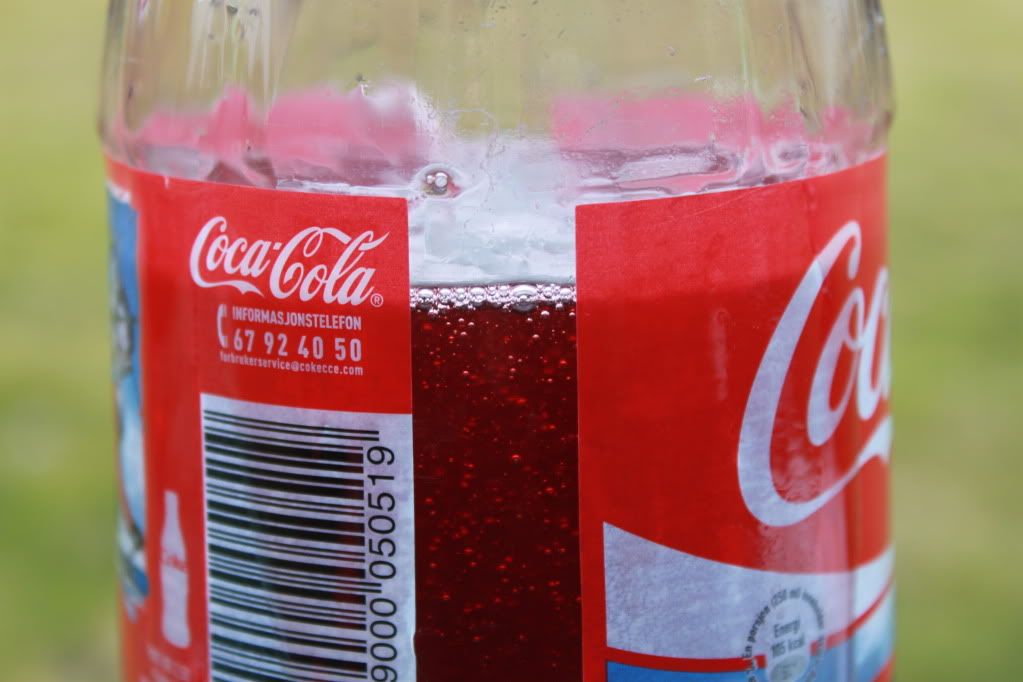

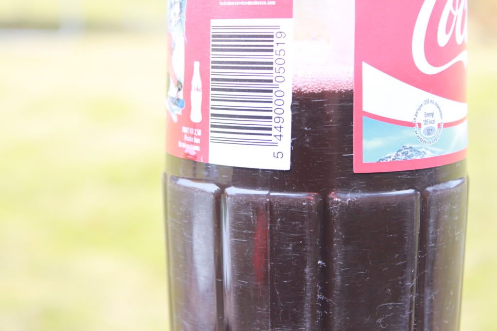

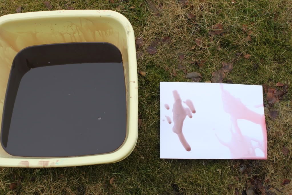

Did a flush (drain & fill) the other day, 20k on the new transmission. Oil looked pretty bad and i figured for some longevity and peace of mind I`d install an auxillery transmission cooler.

Also, that fluid coming out looks rather dark for only 20K on a new transmission..but maybe that's the break-in wear showing!

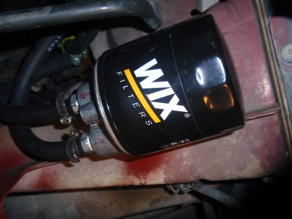

I keep wondering why a spin-on in-line auto engine oil filter wouldn't work? Greater capacity, and has a by pass valve should it ever starts clogging. I know there's a Magnaflow (or something like that) , but why not a simple, inexpensive car oil filter? :?:
bigdaddylee82
Posts: 302
Joined: 22 Dec 2009, 14:20
Year and Model: '95 850 GLT+94 parts
Location: Central Ohio via NW Aarkansas
Been thanked: 1 time
Post by bigdaddylee82 »
byeboy wrote:I keep wondering why a spin-on in-line auto engine oil filter wouldn't work? Greater capacity, and has a by pass valve should it ever starts clogging. I know there's a Magnaflow (or something like that) , but why not a simple, inexpensive car oil filter? :?:
They do:
I put a Derale 13090 filter kit in line between the transmission and the aux cooler I'm using.
matthewsvolvosite.com/forums/viewtopic.php?f=1&t=25601&start=42
