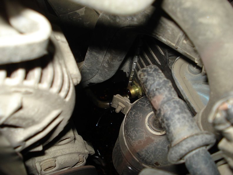

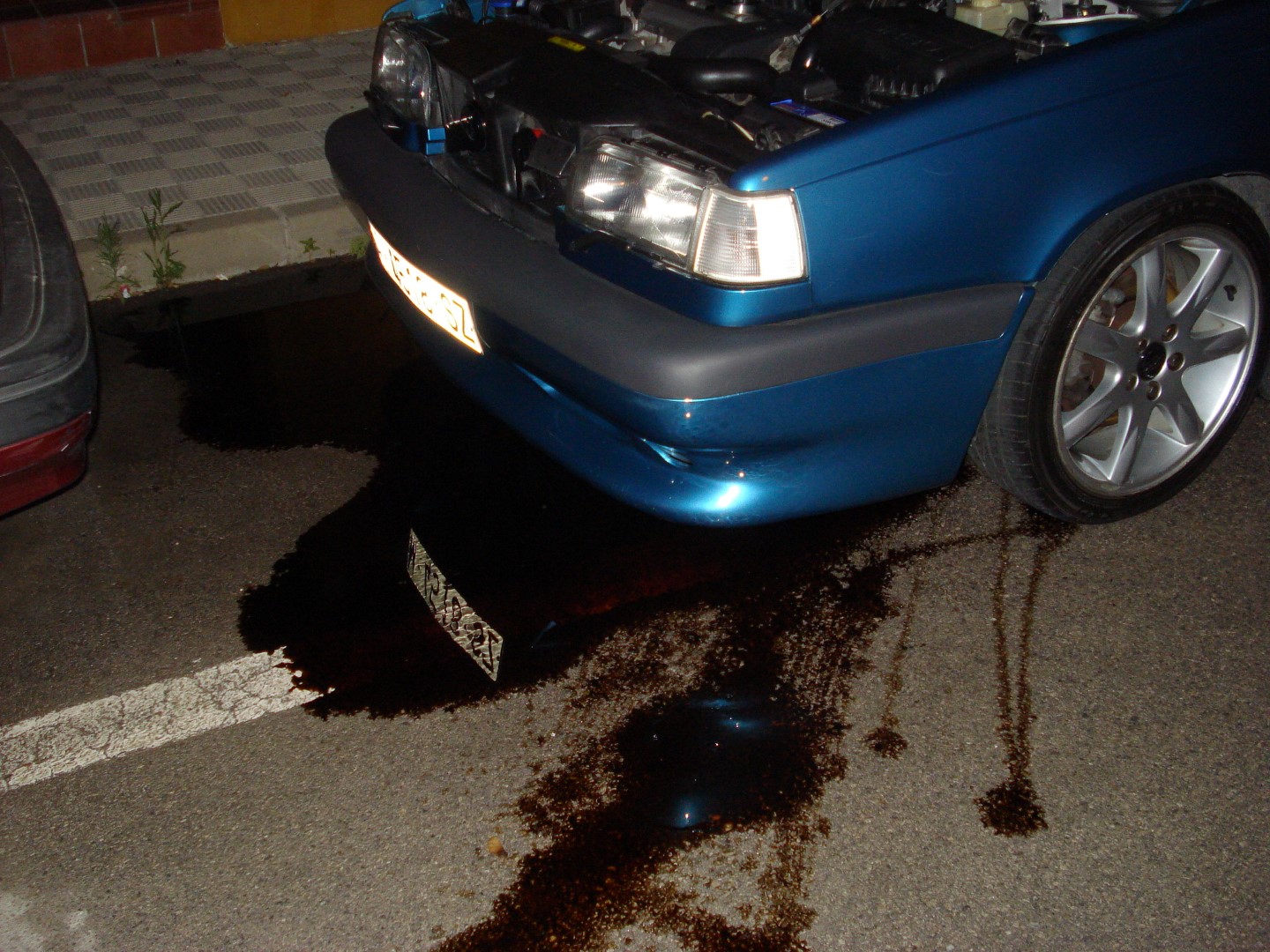

So, last summer my radiator developed a leak, and my mechanic replace it with a new one from Nissens (it seems a good quality item). The radiator included four new clamps for the oil cooler hoses and gearbox fluid hoses, but for any reason those clamps were lost in the workshop and my mechanic reused the old ones, reforced with zip ties. Until now, no problem.
But...a few days ago, I started the car, and when I was getting out of the parking spot, I see the oil pressure light on...I switch off the car, get out...and see a huge oil poodle on the floor...you guessed it, one of the old, reused clamps that connected an oil hose broke. Almost all the engine oil was dumped.

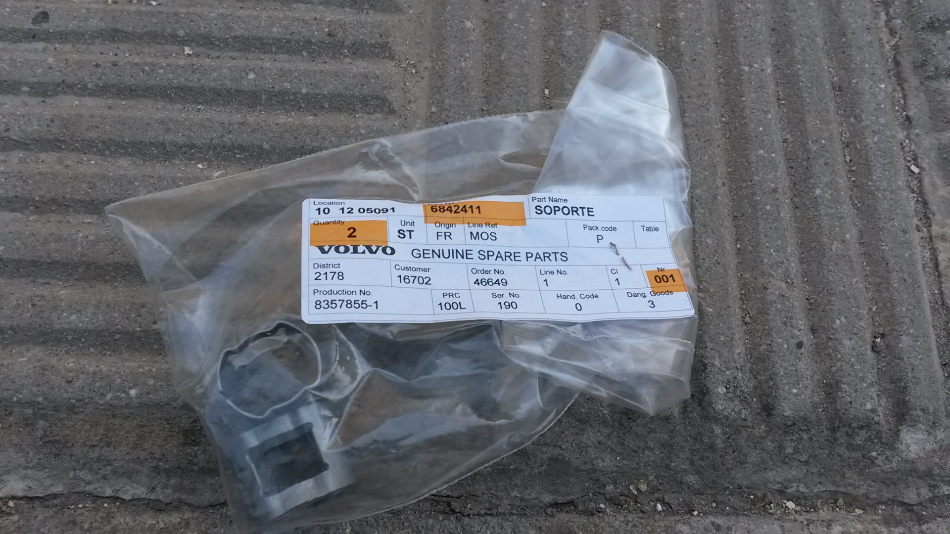

I pushed the car to the parking spot again and ordered new clumps at the Volvo dealer. Installing them was relatively easy.
Some lessons learned:
-There are parts you always have to discard them
-I was VERY lucky it happened at a very low speed, where I could switch off the engine almost inmediately. In the highway, at speed, or in a traffic jam where you can´t get to the hard shoulder fast enough, your engine can be toasted
-Check your oil pressure light in the dash cluster works properly...

Actually, it is safe to re-use the metal clips holding the cooler lines to radiator.
This is true for both engine oil and ATF lines.
The mistake most people makes is that: they flip the clip around. This clip only fits one way!
I posted some photos in forum with screw-type clamp to hold the clips in place.

cn90 wrote:Actually, it is safe to re-use the metal clips holding the cooler lines to radiator.
PS: Barcelona is beautiful!
Oppsss...I´m going to take a look, just to be safe I´m installed the clips the right way...thanks!
