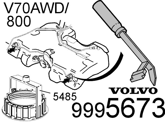

Reinstalling a fuel pump on an AWD P80 series car requires the use of a counterhold. I'm hoping that with a picture of the tool and the procedure graphic, you can figure out how to line up your fuel pump unit. It's likely that the pump is turned from its normal position and you're getting incorrect fuel level. I've never done a fuel pump on an AWD P80 series vehicle, so I can't offer first-hand knowledge. Hopefully this gets you going again.

The LH fuel level sensor is added in series to the RH one. The harnesses can be plugged in wrong easily and it leaves out the LH one. When you do the pump (again) if you do not see any problems with the sender/pump orientation then look to be sure the harnesses are plugged in correctly.

The pump conception will always ensure there are fuel surrounding the pump even when it's almost dry. When you see the whole assembly, the white part is the reservoir encasing the pump. However, the advice to avoid running try is still true to avoid moving some sediments causing it to get plugged and break.
I will be doing the same job of replacing the fuel pump to a brand new Volvo one (current one was a Scan-Tech POS which always leak even when tightened to perfection using proper tools at a indy Volvo shop). By having worked on this 3 times + the indy Volvo job, I have plenty of experience to do the job properly. That thing already hurt my left thumb nail :x
BTW, what would be the proper way to hold the pump in the correct orientation while tightening the lock ring ? I tried using a screwdriver but it ended up crooking the fuel inlets so I must try to find a way to hold it from the bottom...

Lubricate the unit cap with vaseline. The Volvo special tool counterhold works like your screwdriver method and also can bend the metal lines coming out of cap if the "jar lid" won't turn easily on the cap while tightening.
