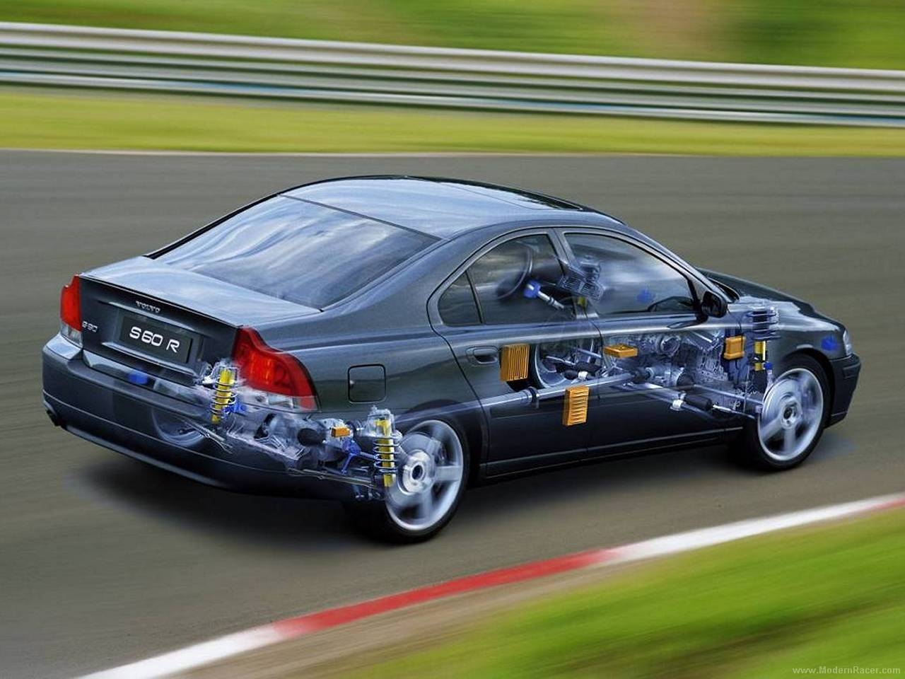

Does anyone have a picture of the drivetrain on one of the AWD models? I'm trying to see how it is set up. What I'm trying to do is turn my c70 manual into an AWD, what are your thoughts on this? Seem possible?

Have to add a different transmission (sometimes), a bevel gear, a center shaft and support, a center diff , a read diff, both rear axles and change hub bearings if needed. This is for the old system. With the new one you will need heaps of electronics. Basically replacing the cars computers with those from an AWD including the computers needed to engage/disengage the AWD coupling.

The only feasible way is to transplant the 98-2000 gen 1 complete with the WHOLE rear suspension. But you will have to be sure the upper shock attachments are there on the C70 chassis. You're going to have to used the AWD fuel tank and relocate the charcoal canister to the front left forward wheel housing.
You really need the WHOLE 2000 model year donor car as there are going to be differences in fuel pressure regulator and lines from the different model years, at least differences 98 to 99-2000.
The big deal will be to figure out if your manual trans has the AWD holes tapped and the splines to drive the cuff that attaches the angle gear to transmission.
Is the wheelbase the same for C70 and the S/V 70? IF not you will have to go with a good shop that can cut down driveshaft length and re-balance it.
You will have to use the steering gear from AWD car and transfer the front subframe. The steering gear is not used as engine mount as on FWD and the casting for engine mount has to be gone for clearance. The subframe needs to have the AWD engine mount reinforcements and holes for the mount. The transmission may have to have the holes for that mount drilled and tapped.
This is an ENORMOUS undertaking and will put your car down for days or weeks.
