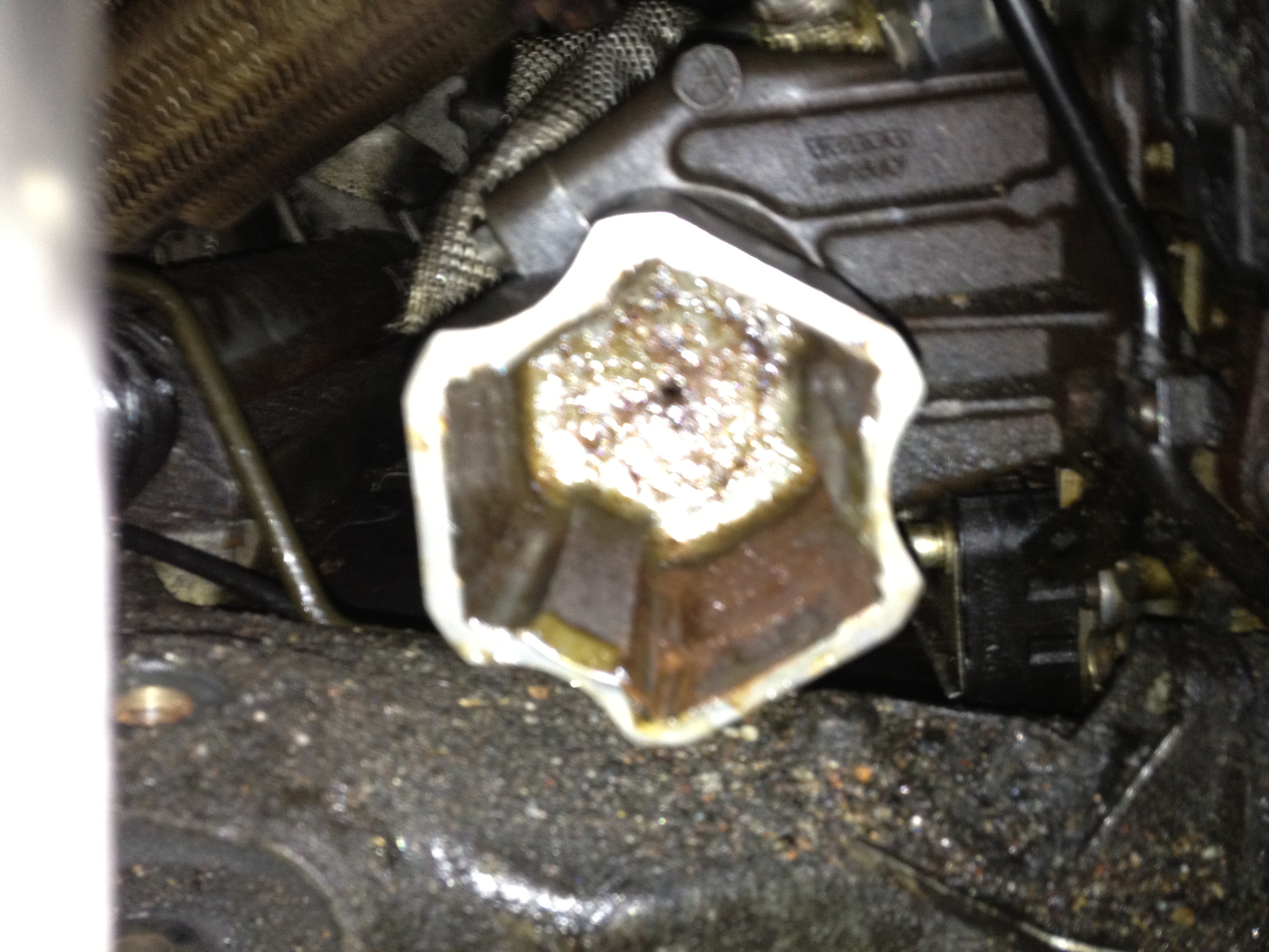

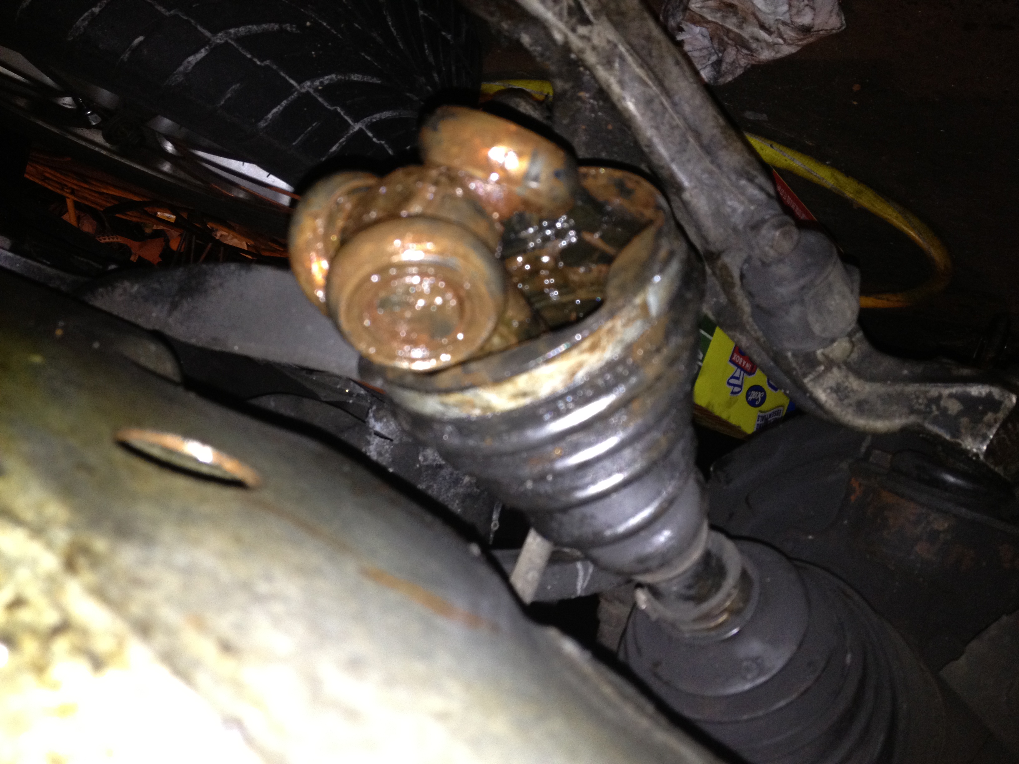

So a year and half later, I get around to pulling this shaft. I cant find anything missing from the inside nor anthing floating in the grease... Any other ideas?
Also cant get the shaft to release from the hub but I'm guessing some heat will help that happen.
