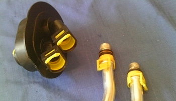

The image below is the new coupling from the dealer (# 3522035 aka "snap on coupling"). The dealer insists the O rings, etc came with this part. Good news to me.
However, below is the business end of the heater core pipes showing the remains of the Orings etc., and the yellow snap on rings.
The new coupler has the yellow snap on already inset as shown.

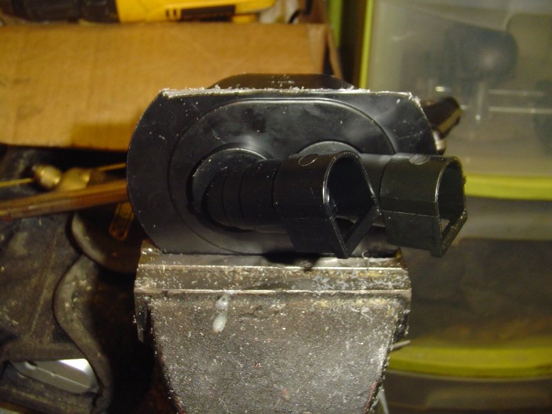

One other thing I did, that helped A LOT, was to trim the side of my coupler down. I was pretty sure I was going to have to remove the entire dash/evaporator housing to get the new one in place otherwise.
Here's a picture of how I trimmed mine. I don't know if I did in significant structural damage, but I don't care. I will NEVER do this repair/replacement to my car again.

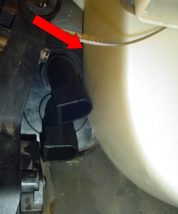

While trimming the lip off of the side of the coupler made it slightly easier to thread back behind the gas peddle, that wasn't my primary reason. I tried everything I could think of, turned every possible direction, and there was NO way that I could get the couplers lip back behind the evaporator housing and inserted into it's hole without breaking something and/or removing the dash. Removal wasn't as big of an issue because I didn't care if the old one broke, I just "man-handled" it out.
Here's a picture of the "modified" coupler installed, and you can see how the lip I removed has to go behind the big white plastic cover (I think that's the evaporator housing anyway).

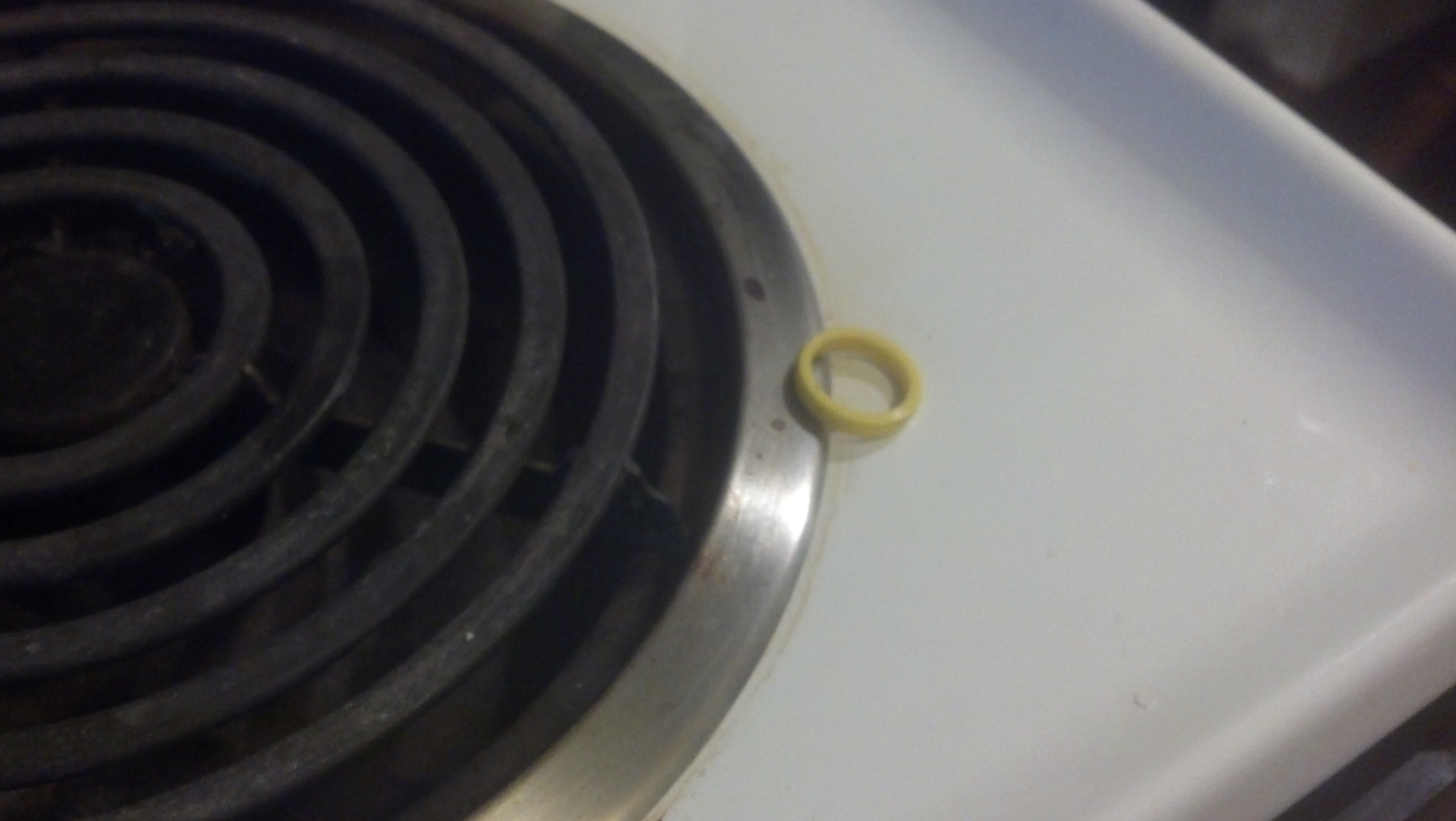

here a picture of the ring that hold the o-rings in
pitch this ring from the engine side of the firewall connector
