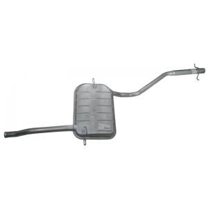

I'm getting ready to do some work on my glt wagon.
Over the past few weeks, I've got it running pretty well. I want to do a turbo-back exhaust, but just don't have the time/money right now, so I've pondered an alternative.
I absolutely hate the stock muffler. It's big, bulky, and has no personality. I've decided I want to remove it. The "flight path" of exhaust gasses must travel through an S curve of muffler packing, and this eats away at my brain.
I'm not looking to get the turbo to spool faster, or increase the diameter of the current set-up. I just want this muffler gone, and I'm sure anything else will at the least light up a little at high RPM.
I plan to cut the pipes close to the muffler, but far enough away to re-clamp it back on if things get hairy. I figure two couplers @ 30 degrees ought to allow a 22" 2.75OD muffler to bolt right on with wiggle room.
I'm not sure what specific brand I want to use yet.
Any insight/comments are welcome.
Exhaust: The Budget Way
